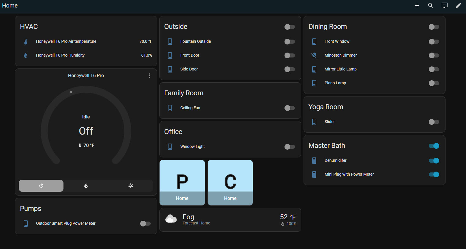

I am going to remove and add back my T6 thermostat to see if can solve an issue I have been having.
Two Questions,
When I add it back, will it have the same node number? Node 010
Will it be easy to add back to the Dashboard in the place it is now?

What do I need to do to keep this as uncomplicated as possible? Do I rename it the same as I have it now?
The entity ID for humidity is sensor.t6_pro_z_wave_programmable_thermostat_with_smartstart_humidity
The entity ID for temperature is
sensor.t6_pro_z_wave_programmable_thermostat_with_smartstart_air_temperature
Do I need to write these down so when I remove the thermostat and add it back it, I make sure these are the same after adding it back?

I had no idea that this was so complicated. I am pot committed but I am not sure I want to remove the Thermostat for fear I won’t be able to get anything to work again.
Any new device I add, I need to make sure I have it exactly correct.
Readd the device to ZUI and in ZUI name it t6_pro_z_wave_programmable_thermostat_with_smartstart. That may be its name
By default
The name I gave it was Honeywell T6 Pro. I may nave renamed it that after I originally added it.
It is unless one already exists then it may become t6_pro_z_wave_programmable_thermostat_with_smartstart_1
Since ZUI is already connected to HA it will auto add to HA before you can rename it in ZUI.
If that occurs, after correct name
In ZUI, a “reload” of the zwave integration should update HA with the renamed entities.
EDIT
That name is crazy so now would be a good time to change it and just do the minor work of making edits in HA to add it to dashboards and automations
You are making it much harder than it is. Why don’t you practice with the Piano Lamp. Put z-wave js in exclude mode and click a button on the device the right number of times (see its docs) and then re-include it and see what happens. Do it again and this time rename it and see what happens. Then exclude again and go back to the original name.
That will get you comfortable doing it.
By the way,
You want to turn up the temp in the room, not in the thermostat. climate.yoga_room is much better than climate.honeywell_t6_pro
