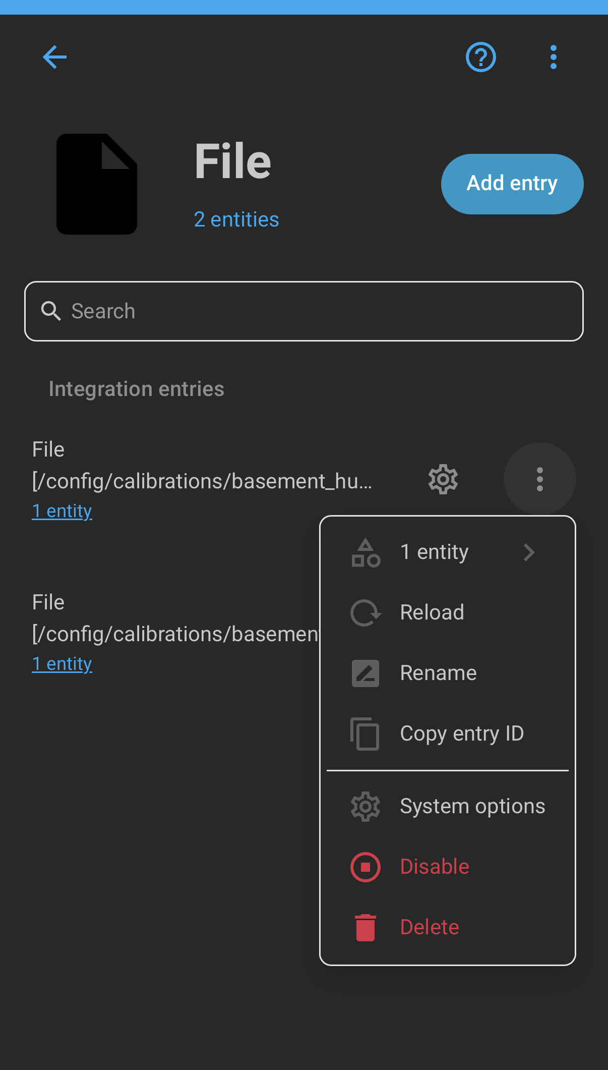

That video doesn’t show you removing the integration. On the integration page, click the 3 vertical dots and then click the delete option at the bottom.
E.g.
