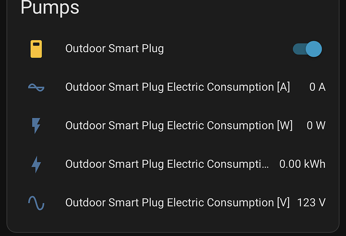

I want to shorten the name. I read somewhere that renaming the device causes some sort of entity issue. Maybe I am misunderstanding however.
What method can I use to shorten the name without having an issue?

Basically any âmethodâ , but various Devices/integrations âreportsâ Names Differently, so itâs hard to use one Method, or give you One suggestion
So something to consider with your example could look like
Dont call it âSmart Plugâ ( Im pretty sure you know itâs a smart plug ! ) And you might not want All your Smart Plugs to be Called " My SmartPlug " i have i.e +40 âSmart Plugsâ
Skip Calling it âElectricâ , im Pretty sure non of your devices consume anything else
" Consumption" is also a matter of taste, Even this i would skip, as All 4 entities ( On each Devices) will end up with this long word.
I Uses a variation of so called ânaming strategiesâ, Depending upon Brand/Integration, And Device-Types.
So decide for each, the first time you install a Device/Integration ( When you know how HA handle itâs Naming ) , And try to get rit of Redundant, Pointless Words

Click on the entity. Click on the cog icon at the top right of the pop-up card. Rename the entity. Save.

I have to agree with Tom, but the question is not how, but if it will have consequencesâŚ
No, it does not, you can rename them as you see fit. But I agree with @boheme61 , use a logical naming convention.
Does renaming a device alter the names of all the devices entities?
Do the new names get automatically adjusted at the dashboards or automations?

Rename the device to âPumpâ.
Renaming the device doesnât automatically change the names of all entities. What you need to do when you rename a device is click on the device so that you see the device page then click the three dots at the top right and select âRecreate entity IDsâ which should open a pop-up showing you which entities will be changed with their current name and new name.

Well it wasnât easy. I had to change everything and I am wondering if anyone in the developer area has thought of a way to make a change in one location that would rename all the entities for a device when itâs renamed?
