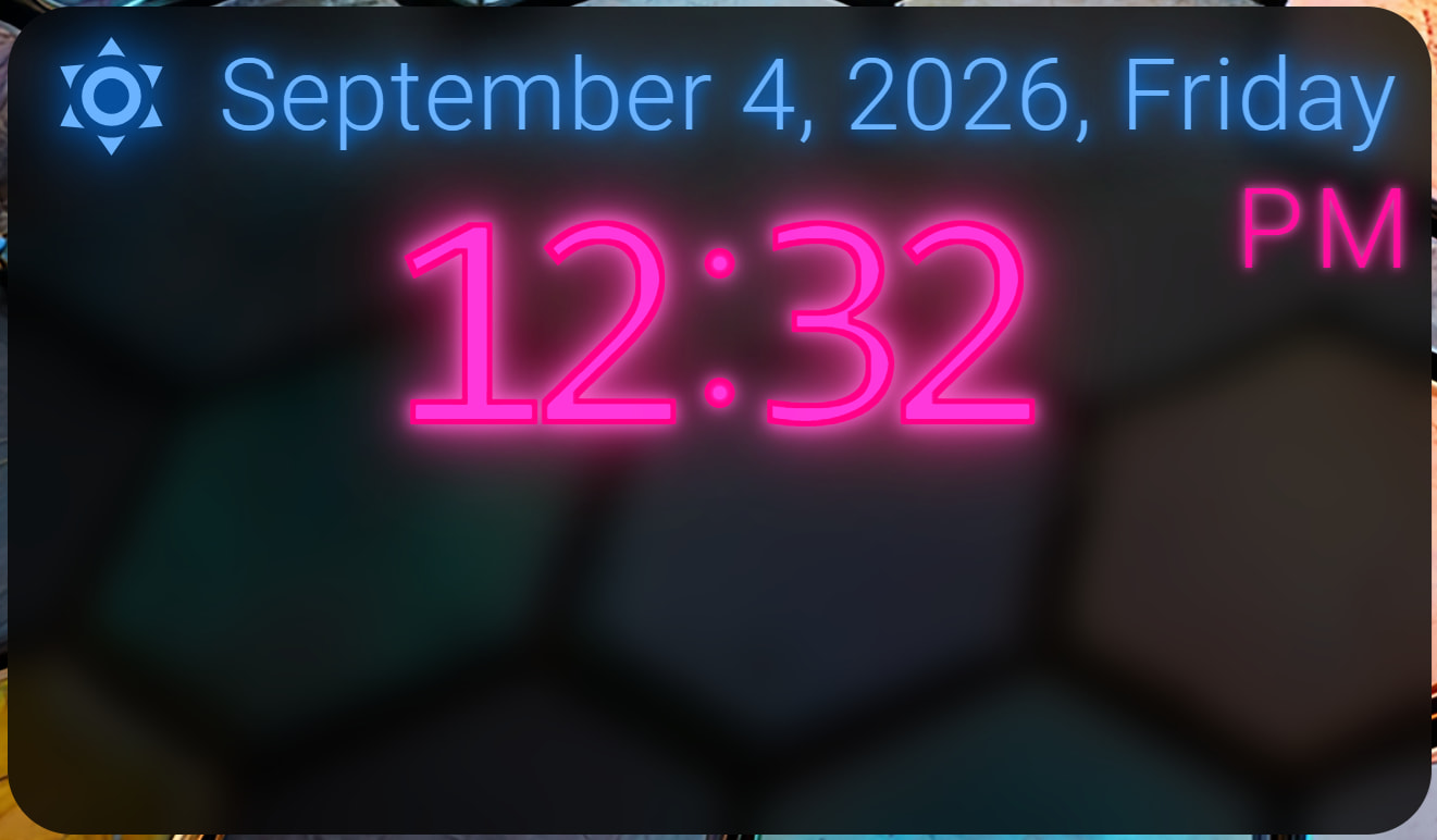

Renix Clock Card hiding bottom area
I love the Renix clock card look, but I don’t need weather data in the bottom area of the card as I have it elsewhere on the same dashboard. Has anyone figured out a way to shrink the card up when the bottom area is not showing? I have tried inspecting the page and tried a lot of variations of card mod code, but the card will not shrink. Any help is greatly appreciated!!
Here is the card mod code I have tried variations of:
card_mod:
style: |
.card-content {
display: flex;
flex-direction: column;
height: auto !important;
.renix-bottom-area {
  display: none !important;
.bottom-grid {
.info-card {
Here is the main yaml code:
type: custom:renix-clock-card
language: en
time_format: ampm
show_bottom_cards: false
show_seconds: false
colon_blink_mode: constant
show_grid: false
show_date: true
show_weekday: true
top_font_size: 4
top_icon_size: 80
top_gap: 20
weather_entity: weather.home_weather_com
top_color_rgb:
  - 107
  - 179
  - 255
top_glow_color_rgb:
  - 0
  - 123
  - 255
top_glow: 2
card_background_opacity: 0.8
card_border_color_rgb:
  - 0
  - 157
  - 255
card_border_opacity: 0
card_radius: 33
clock_color_rgb:
  - 255
  - 0
  - 136
clock_glow_color_rgb:
  - 255
  - 92
  - 203
clock_glow: 2
clock_core_color_rgb:
  - 255
  - 56
  - 219
grid_options:
  columns: full
  rows: auto
show_inactive_threads: false
show_weather_icon: true
card_background_color_rgb:
  - 2
  - 2
  - 2
I was able to fix this by using mod card to force the height with the code below in case anyone else needs this.
type: custom:mod-card
uix:
  style: |
    ha-card {
      max-height: 500px !important;  /* Hard ceiling to force-crop the empty space */
      min-height: 0px !important;
      height: 250px !important;    /* Forces the strict layout envelope */
      overflow: hidden !important;   /* Hides anything extending past 120px */
      background: rgba(0, 0, 0, 0.7) !important;
