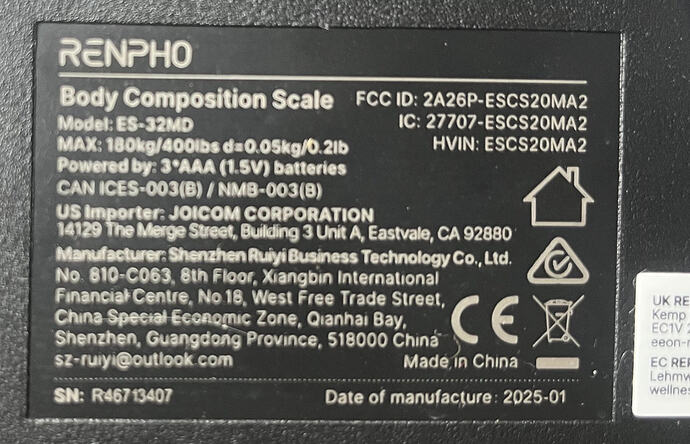

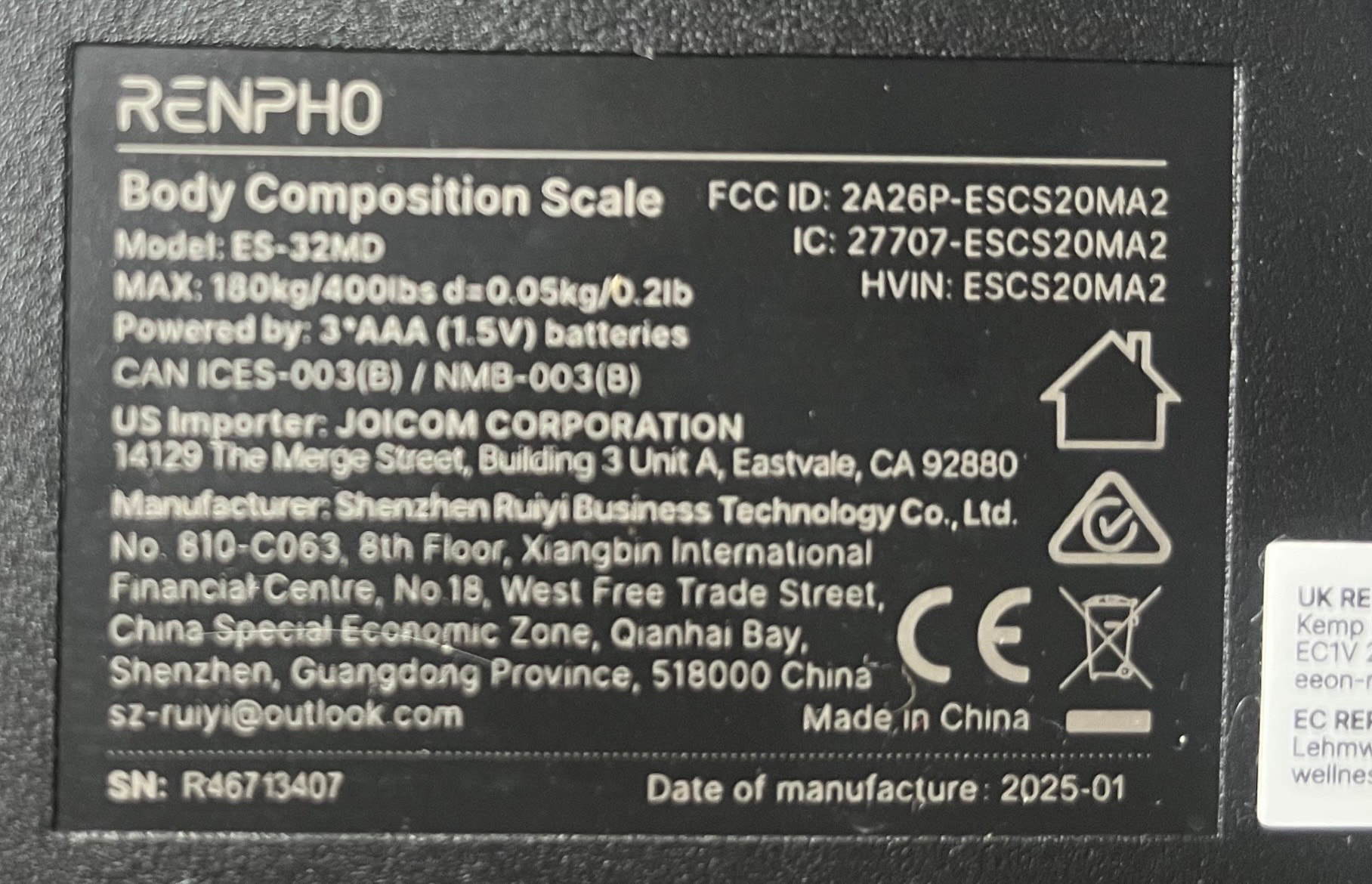

By the way, could you maybe check for me the full model details of your scale on the back of the device (model, FCC ID, IC, HVIN) as well as firmware version if you have it? I want to have a better record of the exact variants the integration works for and I've noticed some models have more than one variant, and it seems for ES-32MD some variants work and some don't.
Sure Ron, ES-32MD FCC ID: 2A25P-ESCS20MA2, IC: 27707-ESCS20MA2, HVIN: ESCS20MA2. Date of manufacture: 2025-01 as per photo
firmware version as per app: v6.0

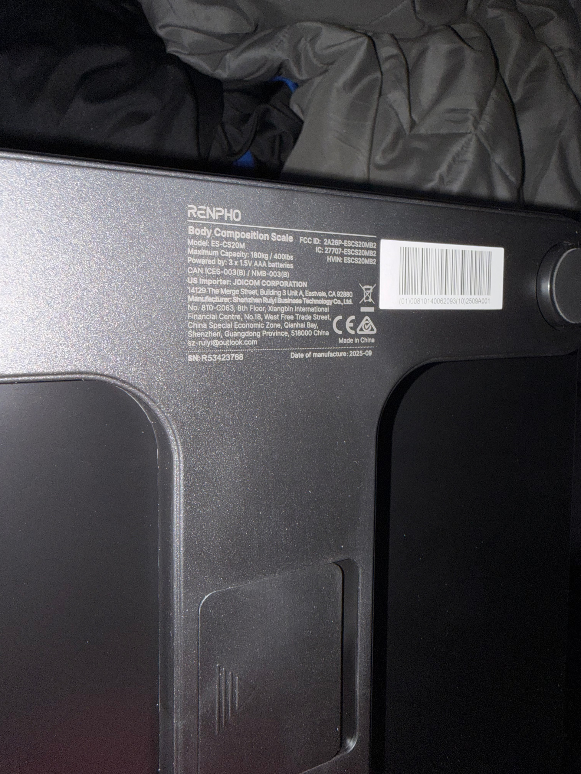

Seems like all the new part#’s getting delivered are ESCS20MB2 models. I have bought and returned 3 different times now and have received the same every time.

Yeah, it seems there are quite a few variants out there. If at any point someone with this variant maps out the protocol it uses - I'll be more than happy to add support for it. If you (or anyone else with this variant of the scale) wants to take a stab at it I'll also happily assist or advise.

By the way, could you maybe check for me the full model details of your scale on the back of the device (model, FCC ID, IC, HVIN) as well as firmware version if you have it? I want to have a better record of the exact variants the integration works for and I've noticed some models have more than one variant.

I just purchased a ESCS20MB2 which apparently don’t work. I am more than happy to assist you in adding support for it. I probably lack skill myself but I am advanced HA user and will manage to follow instructions and do testing/verification! :smiley:
