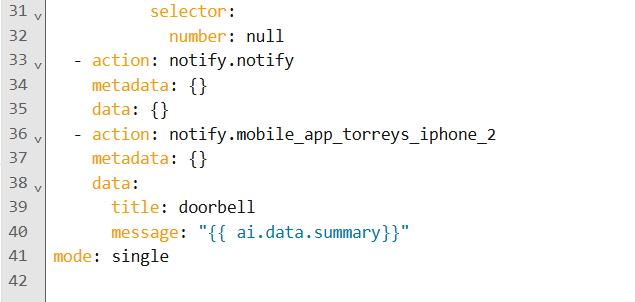

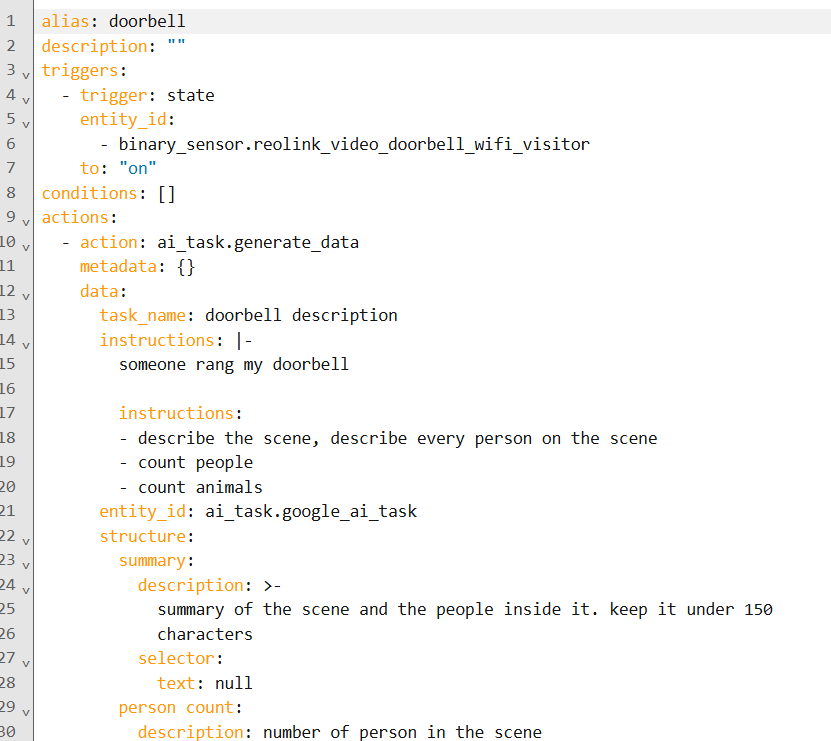

this is what i tried doing. but it doesnt work
In the future, please try to post code snippets as text, not screenshots. They’re much harder to work with as screenshots. I think you have multiple errors in your code. In your ai_task.generate_data action, you have two “instructions” keys (delete the second one, it’s unneeded); also in ai_task.generate_data, you’re missing a response_variable (should be ‘ai’ to match the message template in your mobile phone notification); and last, you have an empty notify.notify action that does nothing because it has no data (delete it). For reference, here’s a snippet from one of my automations (not shown, a time trigger and a weather.get_forecasts action to pull the weather forecast into a response variable ‘weather’):

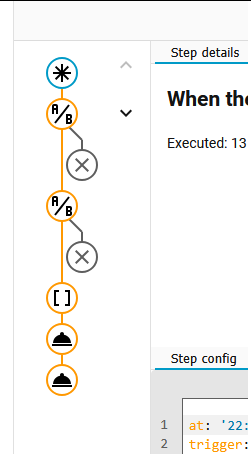

Question, have you checked the Traces of your automation?
By clicking on each step, you can see what worked and/or where the script stopped working.
