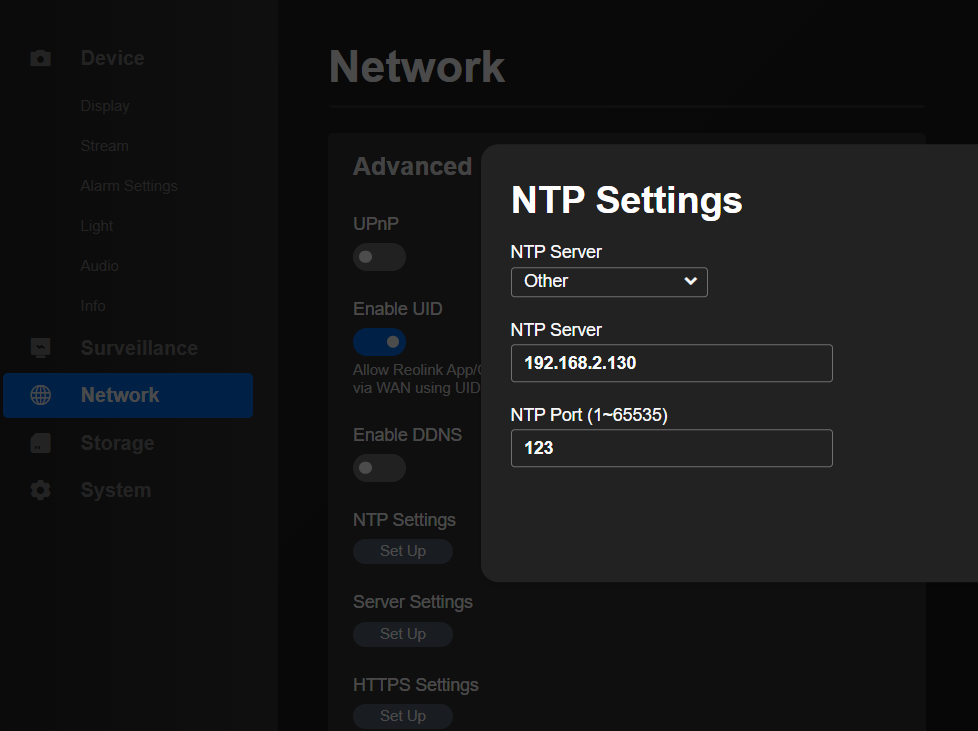

Is there a place for NTP on this camera? Do you have a pic to share? Mine had one with some prepopulated drop downs, and it is a little finicky (just did it this weekend). I had to type in my IP address then click save. If I clicked anywhere else it wanted to change what I had put in the field I put my IP in. Once I hit save it was all good.
  • access the camera with a browser (eg. 192.168.2.137)
  • log in
  • settings (gear icon, upper right)
  • Network (on left)
  • Advanced v
  • (scroll down)
  • NTP Settings (Set Up)
  • NTP Server [dropdown box]
  • Other
  • NTP Server [box] enter IP address (eg 192.168.2.130)
Weird that is how mine is setup as well. I may have to do some tracing later if you see it still going to reolink.

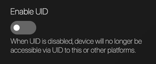

Is UID enabled by any chance?
Webapp > Settings > Network > Advanced
Yes, it was

That's could have been the cause for the traffic then. AFAIK remote access via UID works through Reolink-hosted proxy servers.
