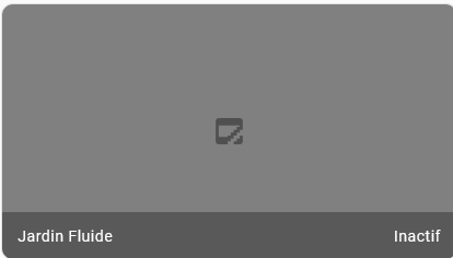

I’m facing an issue with my Reolink cameras (connected via the NVR) in Home Assistant.
For some time now, I haven’t been able to see the camera preview in Home Assistant. Instead, I get this:
However, when I click on the preview, the live stream works perfectly.

I found a workaround for lovelace : use a picture glance instead of picture entity :
camera_view: live
fit_mode: cover
type: picture-glance
entities: []
camera_image: camera.jardin
title: Jardin
But I still have the issue where I can’t take a snapshot while according the documentation it is still possible.
I have the same problem with camera.snapshot on some reolink cameras on my dvr.
For the camera included in the DVR kit (RLK8-800B4) I have this problem! For the cameras I have added next to the DVR like a RLC-810A and Reolink PTZ, no problem with snapshot.
Yes, changing to camera_view: live seems to do the trick, unfortunately you can’t change that on the new Areas dashboard, so it’s forever stuck on the ‘no preview’ image.
Downgrading the camera firmware fixed it for me. On the Reolink B800 PoE cameras, I had to revert to firmware version 3.1.0.2379_23062702 on each B800 camera to get it the preview thumbnails and download snapshot to work in HA.
