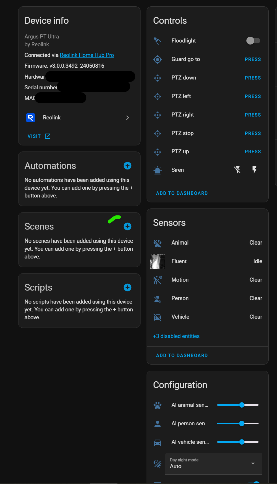

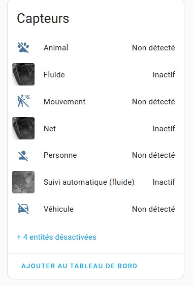

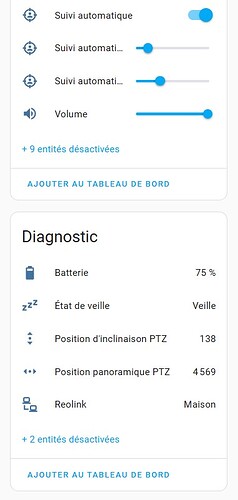

Yes sir. Completely controllable both ways. This Argus PT Ultra is a battery operated cam
Ho boy, that’s great ! What entity or sensor would you use to enable the motion detection when needeed and disable it when not needeed ? You gave a lot of awnsers, especially with this two screenshots.
The sensors are added individually as binary. This allows you to create Automations based off those sensors. For example, if I detect motion from my driveway cam, it sends a notification to my LG televisions
  • Animal
  • Fluent
  • Motion
  • Person
  • Vehicle

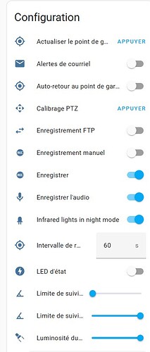

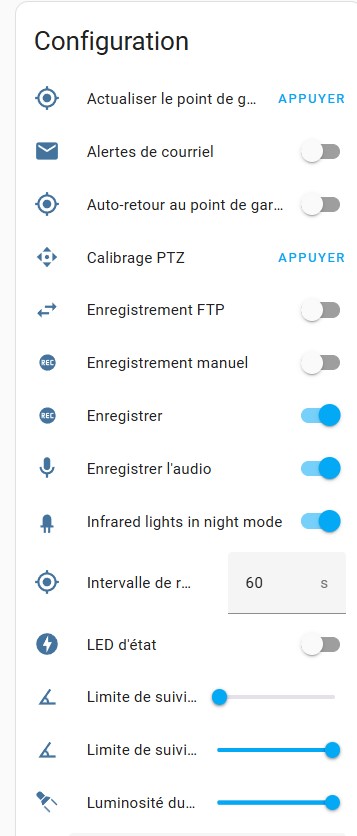

The problem : during the day, when the cameras aren’t in a scheduled monitoring everything is fine. Even with the PIR sensor activated. Each of the two battery camera have their scheduled monitoring. I have attached an HA log when the cameras are with PIR ON and in monitoring mode. So I think the problem comes from when the cameras are on a scheduled monitoring. I don’t have this problem without the integration active. Also attached the configuration of one of my two wifi cameras, the configuration is the same for the two. Maybe there are some sort of conflict because the cameras were already set up before I got my home hub ? Maybe I should desactivate most of the entities ? Also I saw a lot of connection to the camera (trough the sleeping/awake sensor) when I was in the disfunctional configuration (during scheduled monitoring). It was sometimes every ten seconds, sometimes every minute or so. I have no automation linked to the cameras or reolink integration. I tried everything from the troubleshooting guide you posted on the official integration page for elevated battery draining, it didn’t change anything.

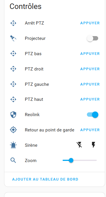

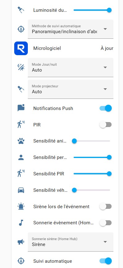

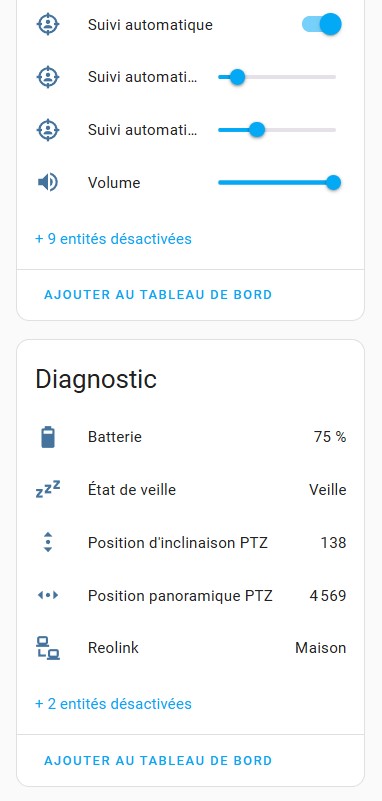

The camera configuration :
