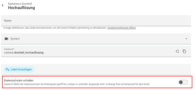

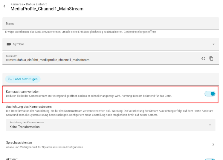

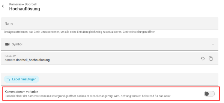

Okay, I don’t have a Reolink E1 Zoom here, but I do have various cameras from different manufacturers. For all of them - including, for instance, my Reolink Doorbell - I have the option to either preload the stream or not. As far as I know, this is a Home Assistant feature and has nothing to do with the camera or the stream itself.
However, if you really don’t have this HA setting available for a particular camera, then unfortunately I can’t offer any further insight into your problem. That said, what is definitely true since Core 2026.8.x is that preloading the stream - for whatever reason - now places a significantly higher load on the CPU (depending on the number of cameras and streams) than was the case prior to that version.

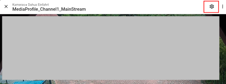

Edit: Click on the camera’s corresponding stream sensor - for example, for a Dahua camera - to access the stream. Then, click the gear icon in the top right corner;
the screen that opens should allow you to enable or disable stream preloading.
By default, however, this feature is disabled.
And this applies to every stream, so it doesn’t matter which stream you use on your dashboard. :wink:
