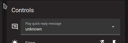

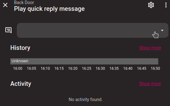

I installed wifi reolink doorbells. The feature to pass pre-wri…tten messages to the device thru Home Assistant worked as advertised.
When I moved those doorbells into a RLN4E NVR, the list remained unknown no matter what I tried to do in the Reolink App or the HA Reolink Integration

I don't think there's an actual error, just no way to populate the pre-written statements for the doorbell to pick up on. Returns 'unknown'.
When the RLN4E NVR was not in use, the field was populated with a list as expected.
