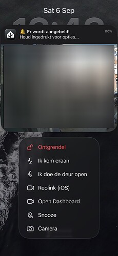

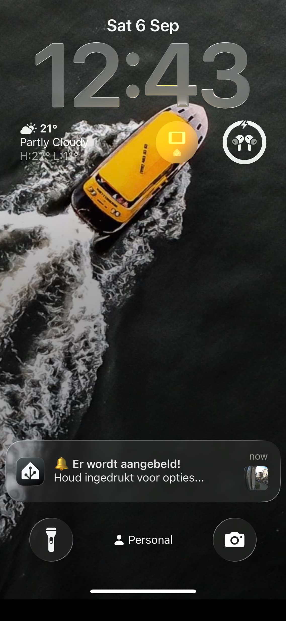

This is my (made generic) config for reference.
blueprint:
  name: Doorbell - Notify with Actions, Snapshot & Quick Replies
  description: >
    Sends actionable notifications with snapshot + quick replies
    to selected devices when the doorbell rings.
  domain: automation
  input:
    doorbell_sensor:
      name: Doorbell visitor sensor
      selector:
        entity:
          domain: binary_sensor
    camera_entity:
      name: Camera for snapshot
      selector:
        entity:
          domain: camera
    notify_devices:
      name: Devices to notify
      description: Select one or more devices
      selector:
        device:
          integration: mobile_app
          multiple: true
    unlock_automation:
      name: Automation to trigger on unlock
      default: []
      selector:
        entity:
          domain: automation
    quick_reply_select:
      name: Quick reply select entity
      selector:
        entity:
          domain: select
trigger:
  - platform: state
    entity_id: !input doorbell_sensor
    to: "on"
  - platform: event
    event_type: mobile_app_notification_action
    event_data:
      action: UNLOCK
  - platform: event
    event_data:
      action: COMING
  - platform: event
    event_data:
      action: OPEN_DOOR
  - platform: event
    event_data:
      action: SNOOZE
  - platform: event
    event_data:
      action: CAMERA
action:
  - choose:
      - conditions:
          - condition: trigger
            id: "0"   # doorbell ring
        sequence:
          - repeat:
              for_each: !input notify_devices
              sequence:
                - service: notify.mobile_app_{{ device_id }}
                    title: 🔔 Someone is at the door!
                    message: Hold to see options...
                      image: /api/camera_proxy/{{ input.camera_entity }}
                      icon_url: /local/Bell-Icon.png
                      sound: ding-dong.wav
                      critical: 1
                      volume: 0.2
                      actions:
                        - action: UNLOCK
                          title: Unlock
                          destructive: true
                          icon: sfsymbols:lock.open
                        - action: COMING
                          title: I’m coming
                          icon: sfsymbols:person.fill.checkmark
                        - action: OPEN_DOOR
                          title: I’ll open the door
                          icon: sfsymbols:door.left.hand.open
                        - action: URI
                          title: Open Dashboard
                          uri: /dashboard-mobile/
                          icon: sfsymbols:rectangle.grid.2x2
                        - action: SNOOZE
                          title: Snooze
                          icon: sfsymbols:bell.slash
                        - action: CAMERA
                          title: Camera
                          icon: sfsymbols:camera
      - conditions:
        sequence:
          - service: automation.trigger
              entity_id: !input unlock_automation
              skip_condition: true
      - conditions:
        sequence:
          - service: select.select_option
              entity_id: !input quick_reply_select
              option: "I’m coming"
      - conditions:
        sequence:
              option: "I’ll open the door"
      - conditions:
        sequence:
              entity_id: automation.doorbell_decline
      - conditions:
        sequence:
              message: Camera requested
                action_data:
                  latitude: "{{ state_attr('person.generic_person','latitude') }}"
                  longitude: "{{ state_attr('person.generic_person','longitude') }}"
mode: single
