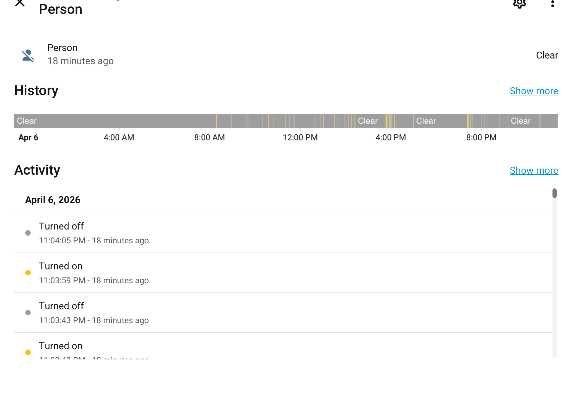

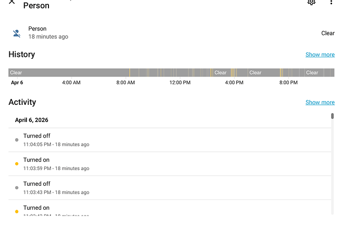

Ok. One thing at the time…
From your initial question I was under the impression that you had problems getting “accurate” person detection from your Reolink camera into HA.
What do I mean by accurate person detection?
Accurate person detection from your Reolink camera in this context is a binary sensor in HA that reflects the status of what your Reolink camera (Reolink Camera) detect with respect to detecting people. In other words - the binary sensor related to person detection should get positive whenever a person is detected and turn negative when a person is no longer detected. Positive would typically be the binary sensor going from off to on.
Do you think that your HA sensor accurately reflect the state that you Reolink App reports? That is why I asked about the history log of your binary sensor. Do you know how to look at this history? Example; Settings - Devices & services; Reolink and select the person sensor. (I attached an example from my setup)
Once you determine that is OK then we can move forward with what automations is doing
I did not know you could do that ! I was only looking at Dev Tools, Entity States, (which never changed as far as I could see) And the good news is that your way shows that the “person” entities do change in those logs. So I guess the issue is really how I have set up the automations. ChatGPT daid I had to put the camera feeds into picture entity cards, in a separate view, then select the “active” camera to show in the notification through the input select. So I guess this is the part that is failing. Is there a better way to get the camera feed into the notification ? I would prefer not to put every camera into it’s own view, but if that is required so that I can point each camera to a different URI, I will just have to live with it. I also would really like the notification to only trigger if it is specifically a person or vehicle - at the moment it just triggers (without the camera feed) on any motion.
