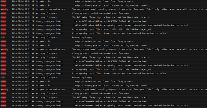

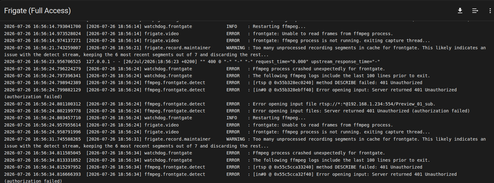

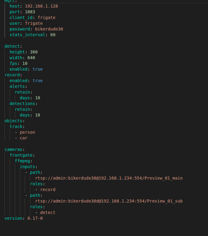

I am including 2 screen capture my yml file, the logs from frigate integration and log from frigate application.
plase assist me in cleaning this mess up
