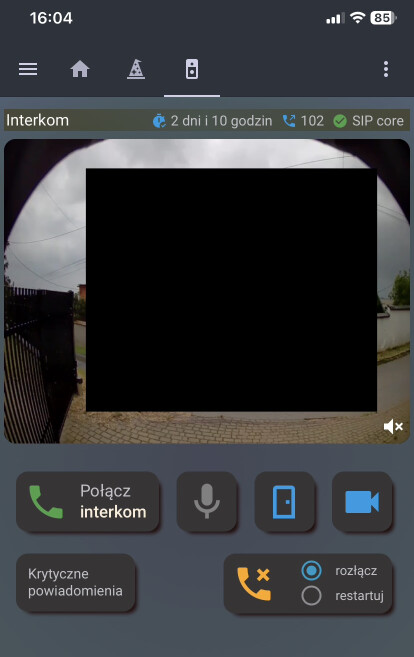

I use the webrtc-camera card because I can dynamically change its behavior, when working with go2rtc. But it does have its quirks. Sometimes (fortunately, very rarely) it won't display the stream. A simple page refresh doesn't help: I ​​need to restart the companion app on my phone.
As I mentioned, I like the dynamic nature of this card. For example, I have a view for intercom calls. The calls are placed via SIP, but I can switch the camera audio independently of SIP.
