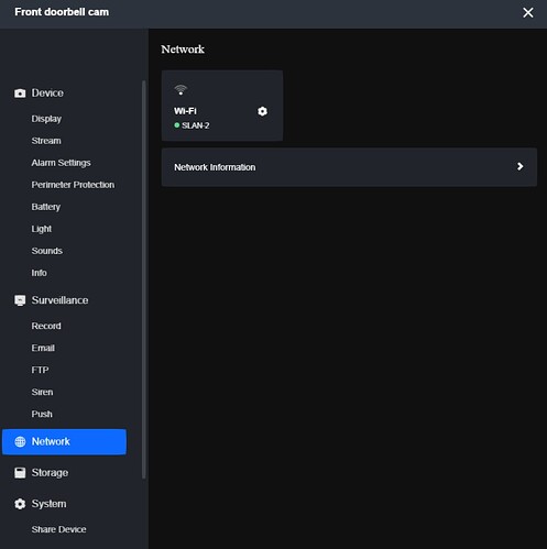

This seems like it should be easy, but I don’t have any advanced settings on my network tab - either in the App or the Reolink desktop client. When I try to connect to the camera IP through my browser, I get “connection refused”. The screenshot below is My reolink desktop client - mobile app is simliar. (yes my other camera does have those advanced network settings) This definitely is a Reolink problem, but any advice would be appreciated. I did try a firmware update, but it told me I have the latest.

So the second time around, I deleted it from the app, and I was able to log back in by entering the UID (got it from desktop app), telling it the wifi was already configured and then it gave me a password entry screen (with no username) and it took it. But… it still doesn’t show me the advanced network options even though I can do other admin type things like share the device or change the password.
so… still stuck… I’ve emailed Reolink for help on this & will post if I find out more.
