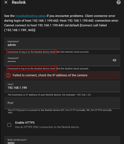

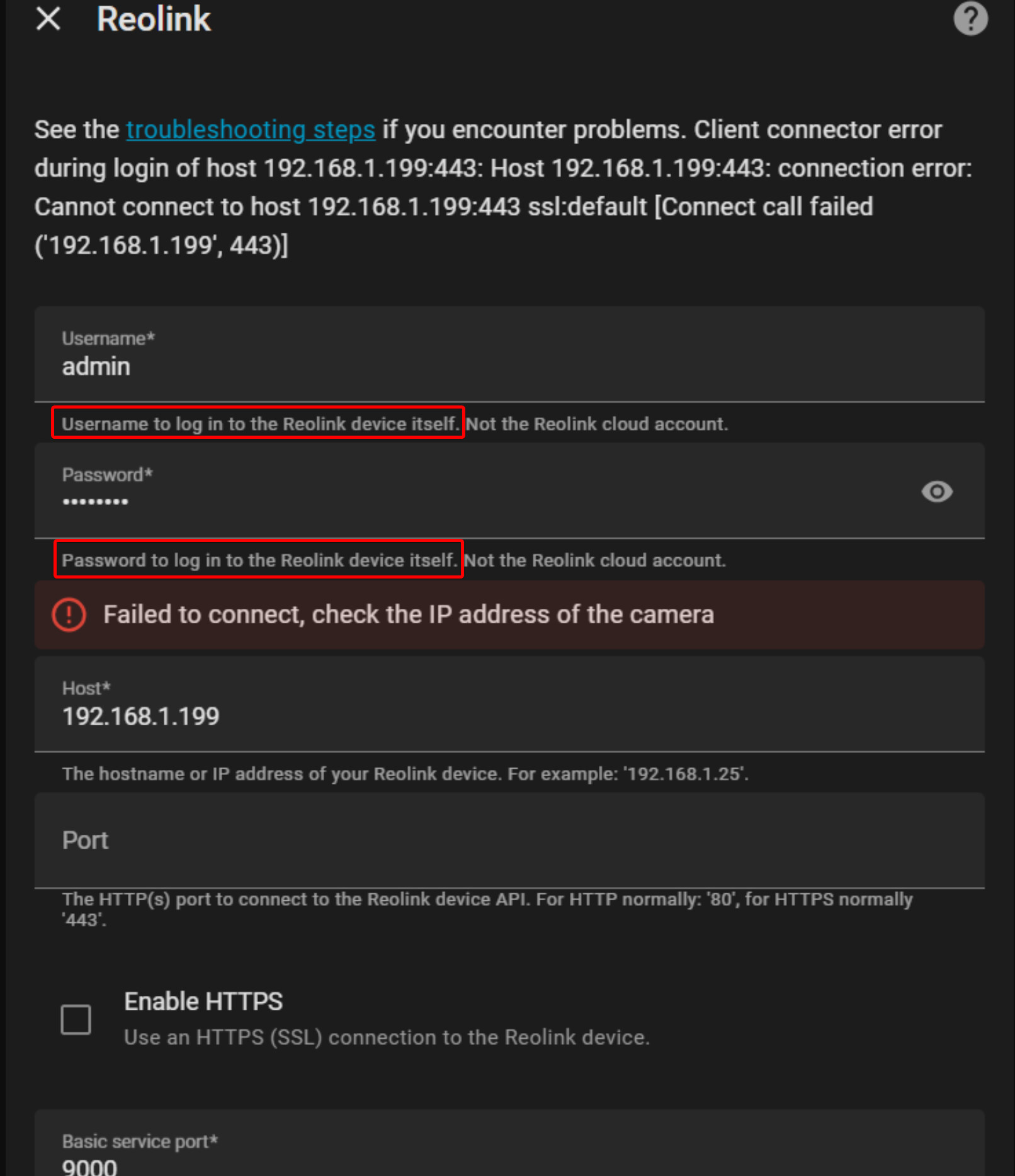

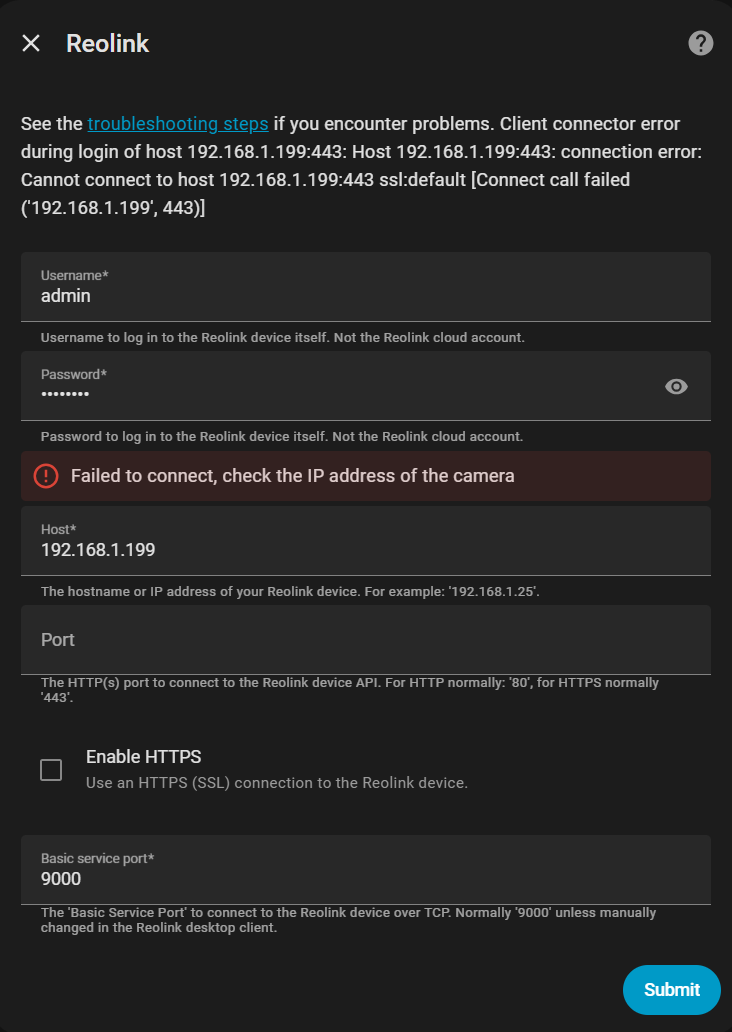

I just replaced our Ring (1st edition, ancient) with a Reolink Wi-Fi. I cannot figure out for the life of me where to get the login information that the integration requests:
It finds the correct IP, but I have no idea what the username/password would be. Its not accessible via its IP in the browser.

I’ve done all that. Its on my network, but I have no idea what the login setting is that the Integration wants. Never at any point did I set that up.

You never mentioned if you have a Reolink NVR.
It looks like you may only be able to add the Reolink Integration by pointing it to the NVR’s IP address.

Unfortunately, that does not work. When using the app to setup the reolink, there is no prompted username. Only the cloud username. It specifically says that doesnt work (and it doesnt). Outside of that, there is no username used to log into the reolink doorbell, from the Reolink cloud app.
Based on others replies, it seems like its not possible to use this doorbell in HA, without a Reolink NVR.
Sorry, not the cloud account but the password for the doorbell device. Try going into the settings for that device in the phone app and then go to to Advanced, then Change Device Password and assign a password. Use that password along with admin as userid. It works for me but I have the wired doorbell and I believe that you have the battery version so this might not apply.

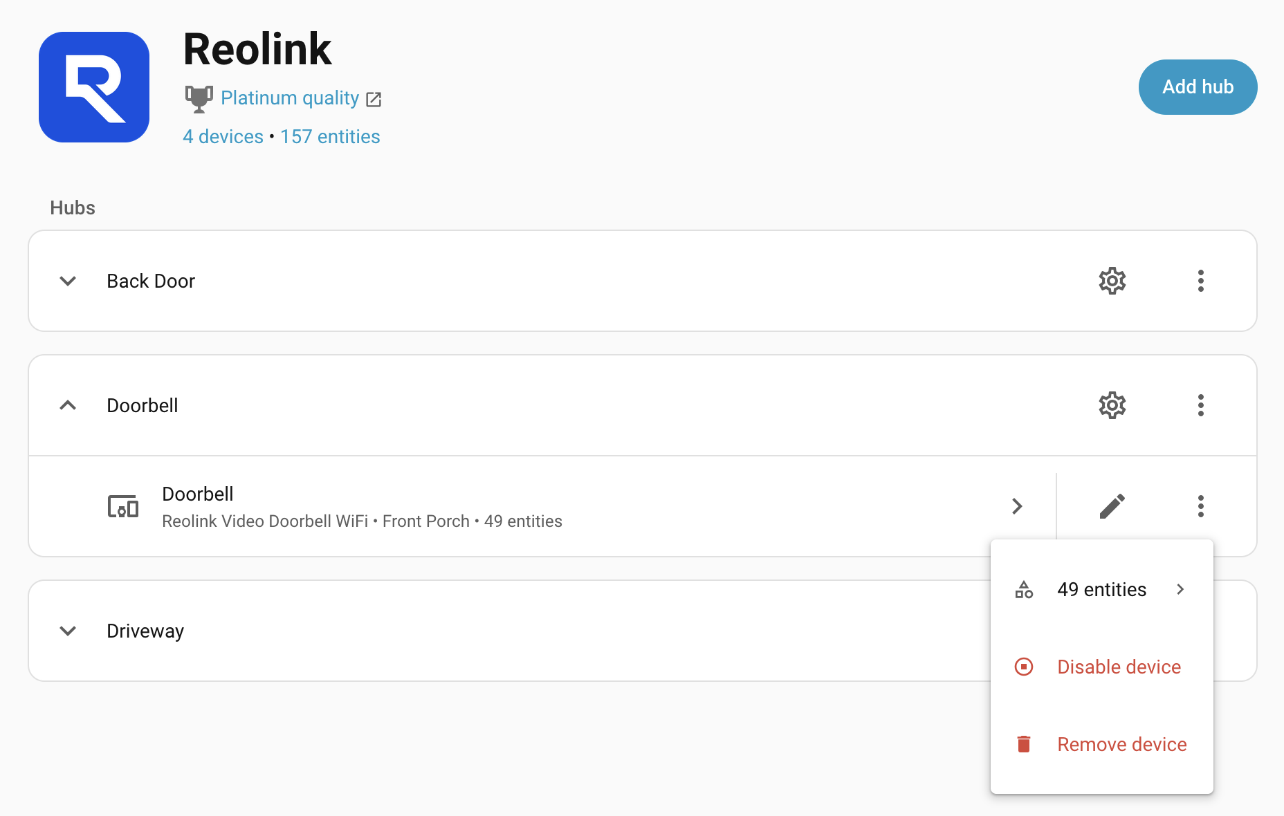

I did the camera setup. At some point during setup, I created a password for the admin user of the CAMERA itself, not a Reolink Cloud account. I’ve never had a Reolink cloud account, nor do I want one. My storage is on an SD card in the camera. I think the cloud account is only neccesary if you sign up for their cloud storage? That password that I created is what I use for web access & integrating into HA. I’ve since created a new admin account with a different username than “admin”. I think I did that in direct web access to the camera.
It has about 50 entities (controls, sensors, configs, diagnostics) in HA.
