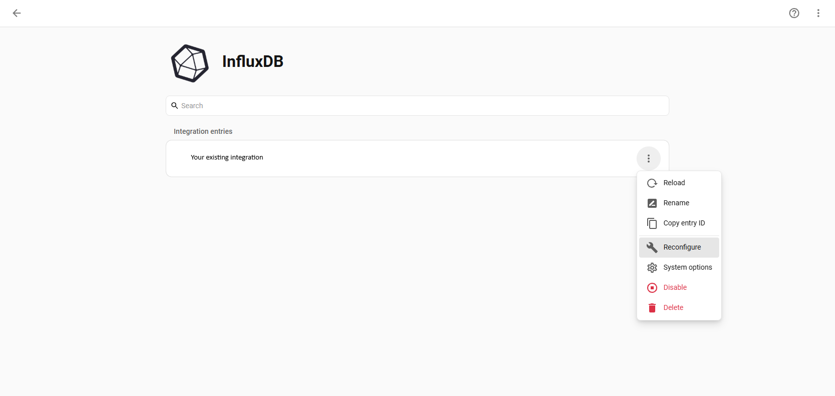

Step 8 - Reconfigure the HA InfluxDB Integration
VictoriaMetrics natively accepts the InfluxDB line protocol, so you can keep the existing InfluxDB integration and simply reconfigure it to point at VictoriaMetrics. However, the integration only supports one instance at a time and does not allow editing the host in place — you need to remove the existing integration and add it again with the new connection details.
First, note down your current InfluxDB integration settings (database name, any tags or exclude filters you may have configured) so you can replicate them. Go to Settings > Devices & Services, find the InfluxDB integration, click the three-dot menu and select Delete.
Then add it again using the Add Integration button, search for InfluxDB and enter the new connection parameters:
  • Host: the internal Docker hostname of the VictoriaMetrics addon, visible on the addon’s info page in HA (example: 1bd4a9fb-victoria-metrics)
  • Port: 8428
  • Database: homeassistant (same name as was used in your InfluxDB configuration)
Leave username and password empty. Re-apply any custom settings you noted down from your previous configuration. Save and confirm that new sensor data starts appearing in VictoriaMetrics.

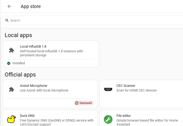

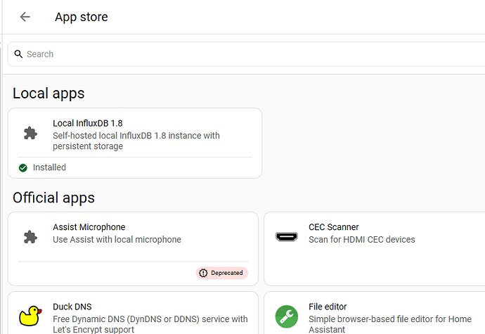

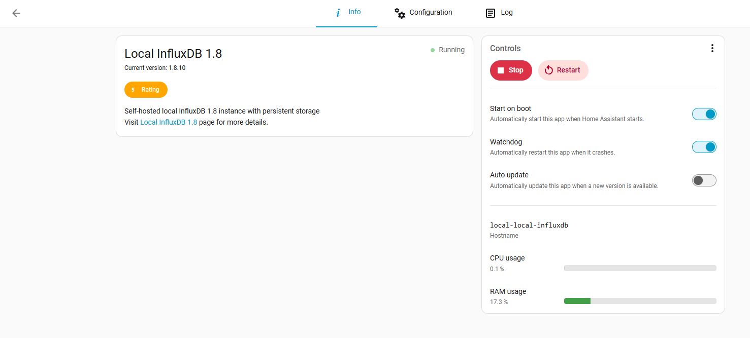

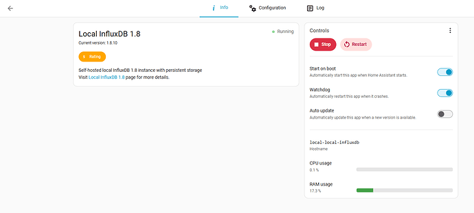

One option is to host it yourself as a custom app within Home Assistant. For me, Grafana is configured via IP address to the InfluxDB data source, and it picked up the new add-on automatically. I advise using an AI tool to help you with this, but the steps are:
> backup databases via terminal commands
> stop the running instance/app
> create new local app Docker files
> install it from the App store
> reconfigure from Devices & Services
Tested and working now. Adding few screenshots.

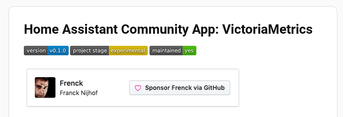

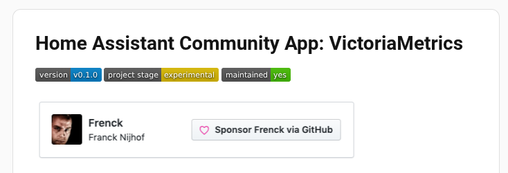

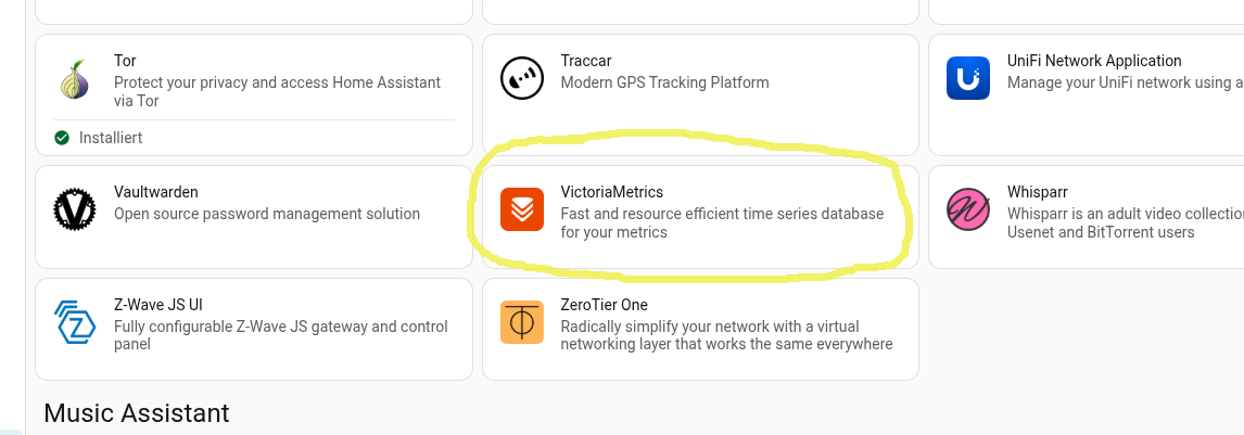

Thanks for your guidance. VictoriaMetrics App is now in the official " Home Assistant Community Apps":
I guess I will migrate to that, then, and try your instructions.
P.S. OK the “project state” of the VictoriaMetrics App ist “experimental” currently, so I will wait some weeks and will not change anything with my HA instance until things have cleared.
