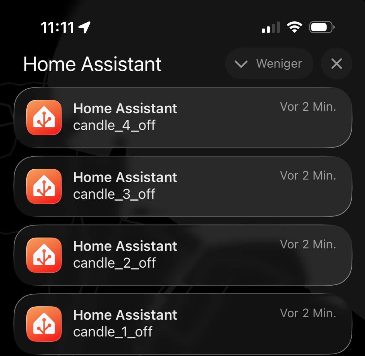

The variable repeat.item in the action script.ir_blaster is not passed correctly to the script. However, it works with the same syntax of "{{ repeat.item }}" in the notify action.
The botifications are always sent with the corresponding content from repeat.item:
When I manually set the value of command instead of using the variable, the script gets executed correctly and the IR command will be sent.

You probably need a delay in there unless your ir_blaster script is running in queued mode.
And even so, Some IR blasters might return as soon as they received a command. The command itself might take as long as a couple of seconds. Sending the next one straight away could lead to either being aborted.
Usually a smartphone camera can show the IR blaster light, so you can see how long it transmits. Experiment with the delays to see how short delays can be.
Usually a smartphone camera can show the IR blaster light, so you can see how long it transmits. See if it works with long delays, then experiment with the delays to see how short delays can be.
You can tell if it’s passed to the script correctly by looking at the scripts trace’s changed variables section on the main node.
You’ll see it is passed correctly and you’re likely focused on the wrong problem.
Thank you guys. I had to add a delay in my IR script. I did some tests and added a delay of 2 seconds, before the commands getting sent.
The IR transmitter was overwhelmed by that many requests.
