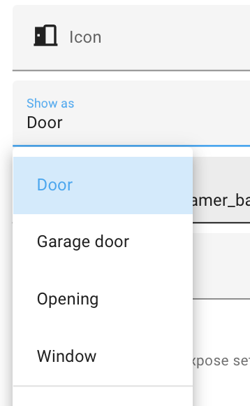

I want to replace default icons for a door. But Home Assistant applies the status of the sensor to the icon. How can I make sure that a custom icon has also two states, that show in e.g. my entities card.
You could have voted for this eight months ago:
Basically: there is no method to do what you want other than choosing from a limited set of device classes.

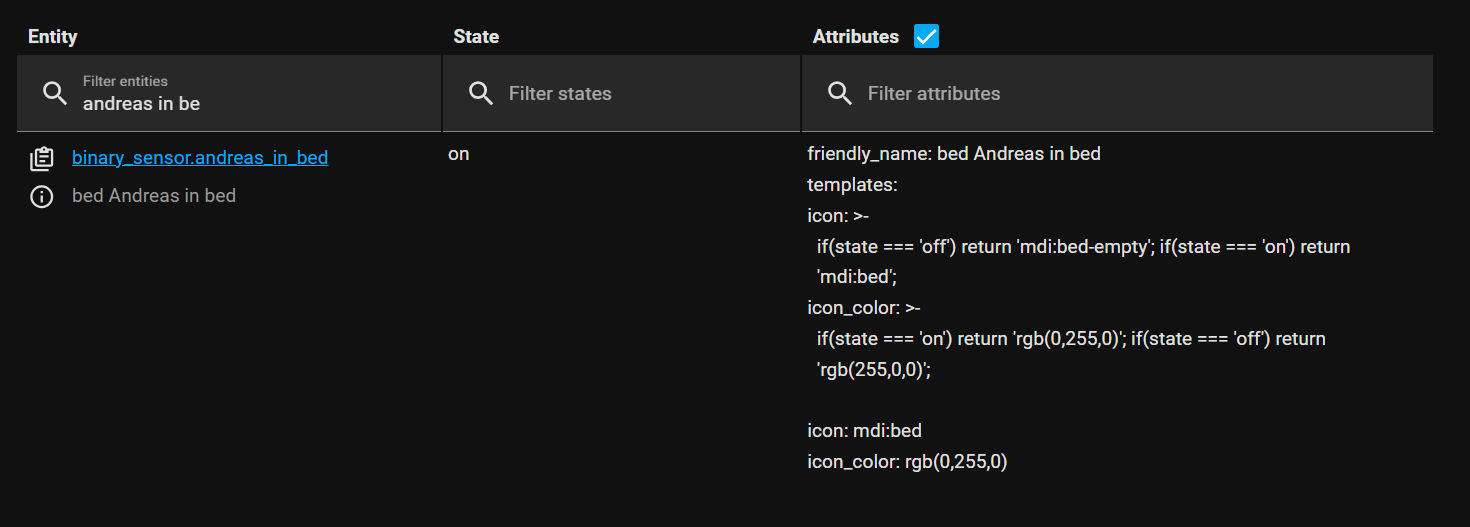

I get this output:

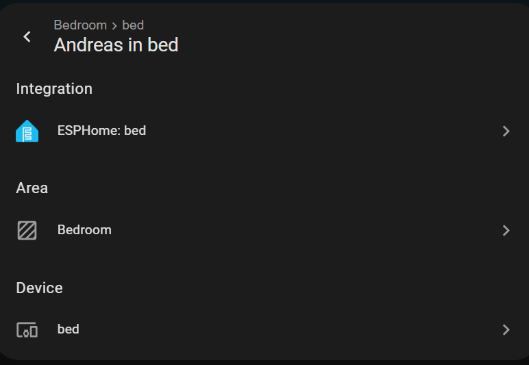

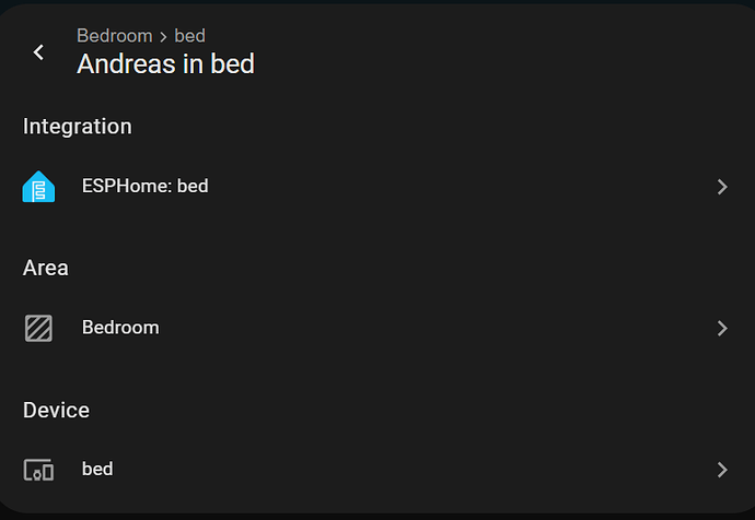

My entity comes from an ESP:
And the customize sets the templates part of the entity
