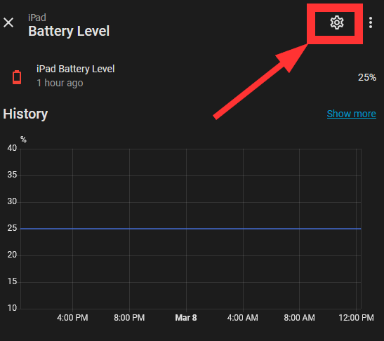

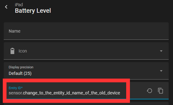

  3. go to the “new” entity/device that replaces the dead/old device/entity
  4. Open up the entity → Cog →
Change Entity ID accordingly
Dont know it this creates other issues and if this is recommended to do, BUT it is possible.
