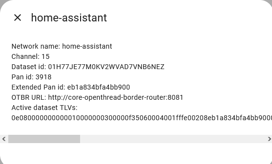

A, I have more then 1 HA instance. You can find the thread credentials in /config/.storage/tread.datasets. Just make sure they stay the same.
Thanks for the tips. I will try.

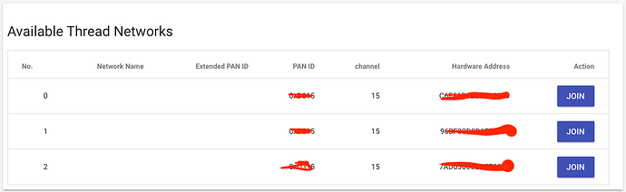

Also I can see some available networks:
Any further ideas?

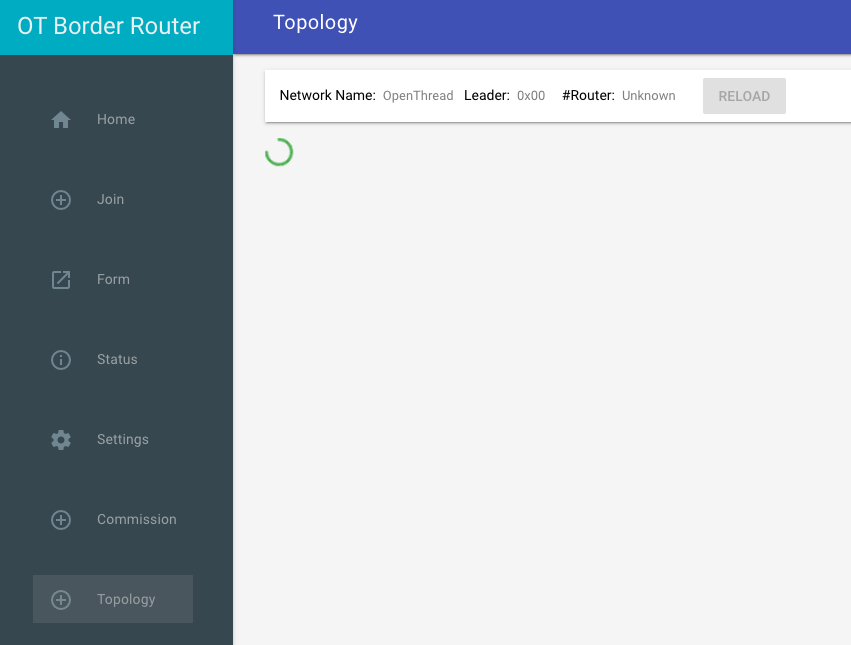

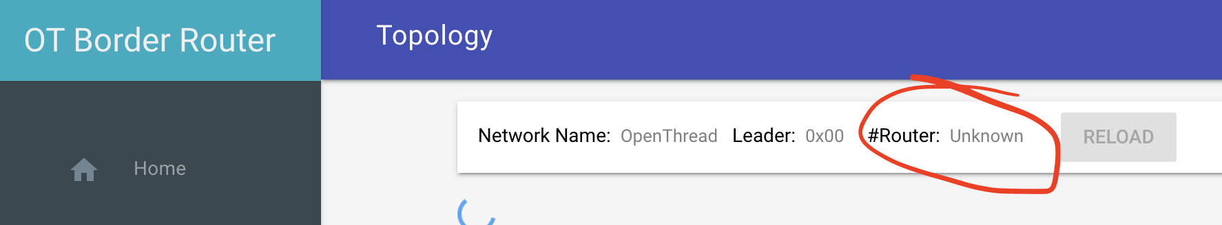

Let’s take a look at the logs from the OTBR.
Lets do that :slight_smile:
Logs from OTBR

The OTBR web interface is notoriously sub-useful. Do you see anything in the Join tab? If the PAN ID looks right, see if it the JOIN button works.
My guess is OTBR will not automatically add new hardware device (interface) to an existing “formed” network — it’s a router, after all, it won’t make assumptions about interfaces. It may’ve been easier to stand up a separate new instance of OTBR, but if you can’t “Join” there are still a couple ways to proceed to avoid having to re-pair all your Thread devices. In either case you need to have the previous Thread credentials saved somewhere — either as a preferred network in HA or as a TLV string.
If the credentials are still saved in HA as the preferred network, then you could just form a new network with any new credentials, and when it appears in HA Thread configuration, use the three-dot menu to join it to the previously-saved preferred network.
If that doesn’t work, you’ll need enter the TLV manually in OTBR. That’s a little more complex, so let us know how far you get with these suggestions.
