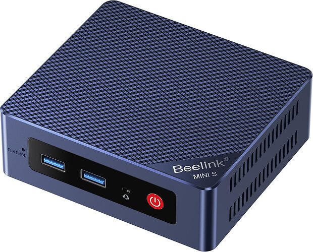

Yeah, hard to pick. I have two of these, but I was shopping for a quiet unit. No problems with it, but not stressing it much. I run Poxmox with HAOS (vs bare metal HAOS).
I’m sure there’s a lot of other options.
