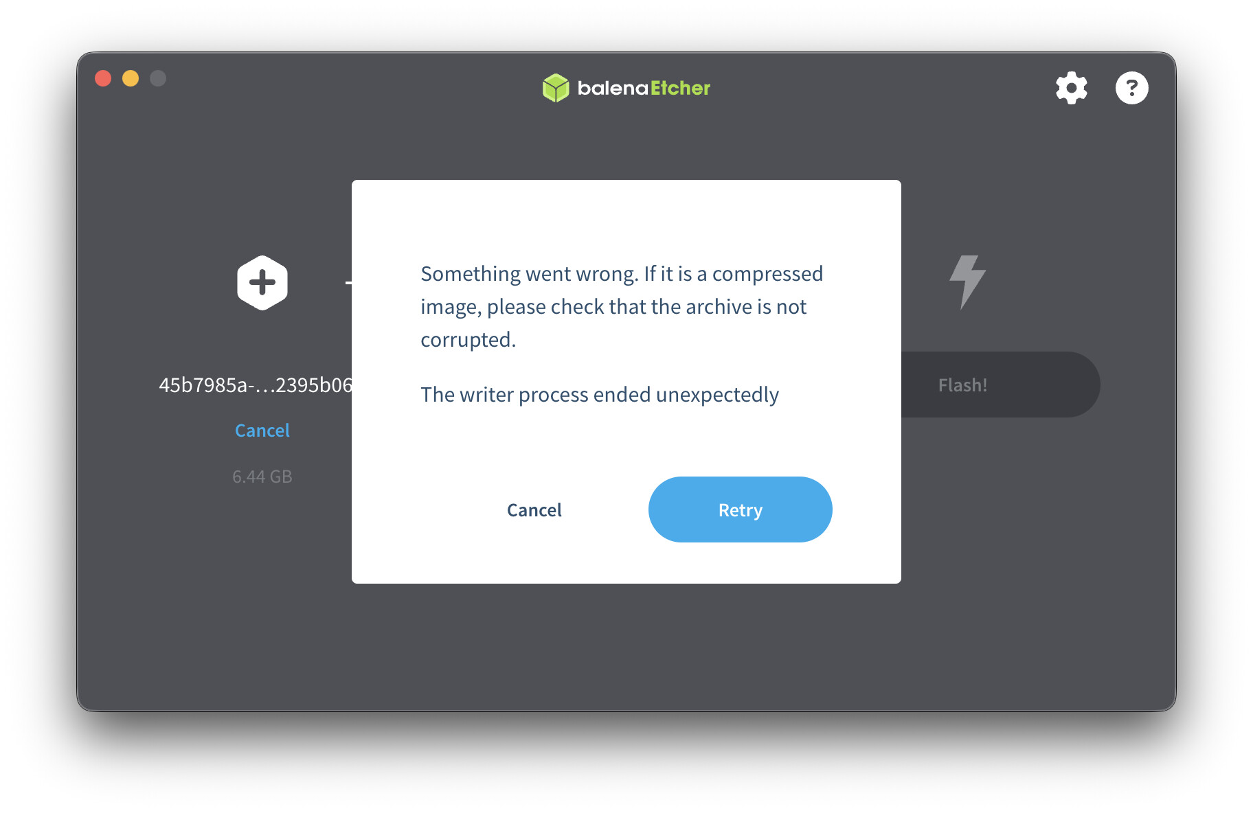

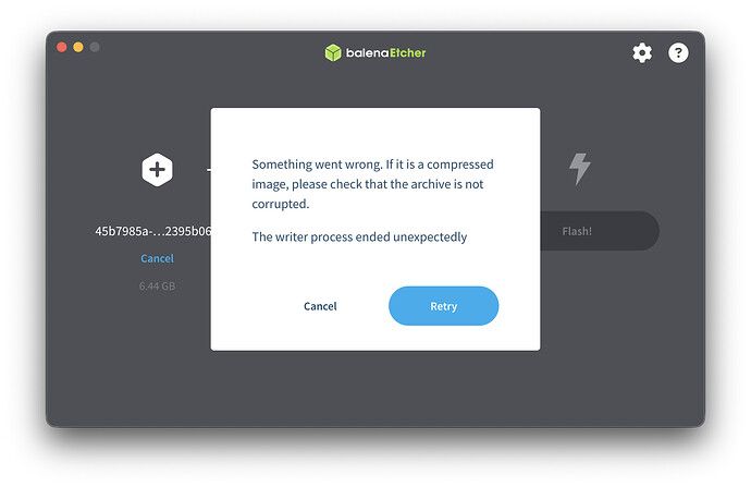

So I got my NUC but the HAOS installation instructions are not working for me.
I have a nice new MNVe drive for the NUC. To flash the HAOS image on it, I put it in a USB enclosure, connected it to my laptop, and tried to use Balena Etcher to write this image to it (as specified in the instructions linked above). I’ve tried this a dozen times, from 2 different computers and using both “Flash from File” and “Flash from URL” and the failure is the same every time: Balena chugs for a while gradually completing the bar chart for flashing, then proceeds on to verifying, slowly completing the bar chart there as well, and then it displays a message that: " Something went wrong. If it is a compressed image, please check that the archive is not corrupted. The writer process ended unexpectedly"

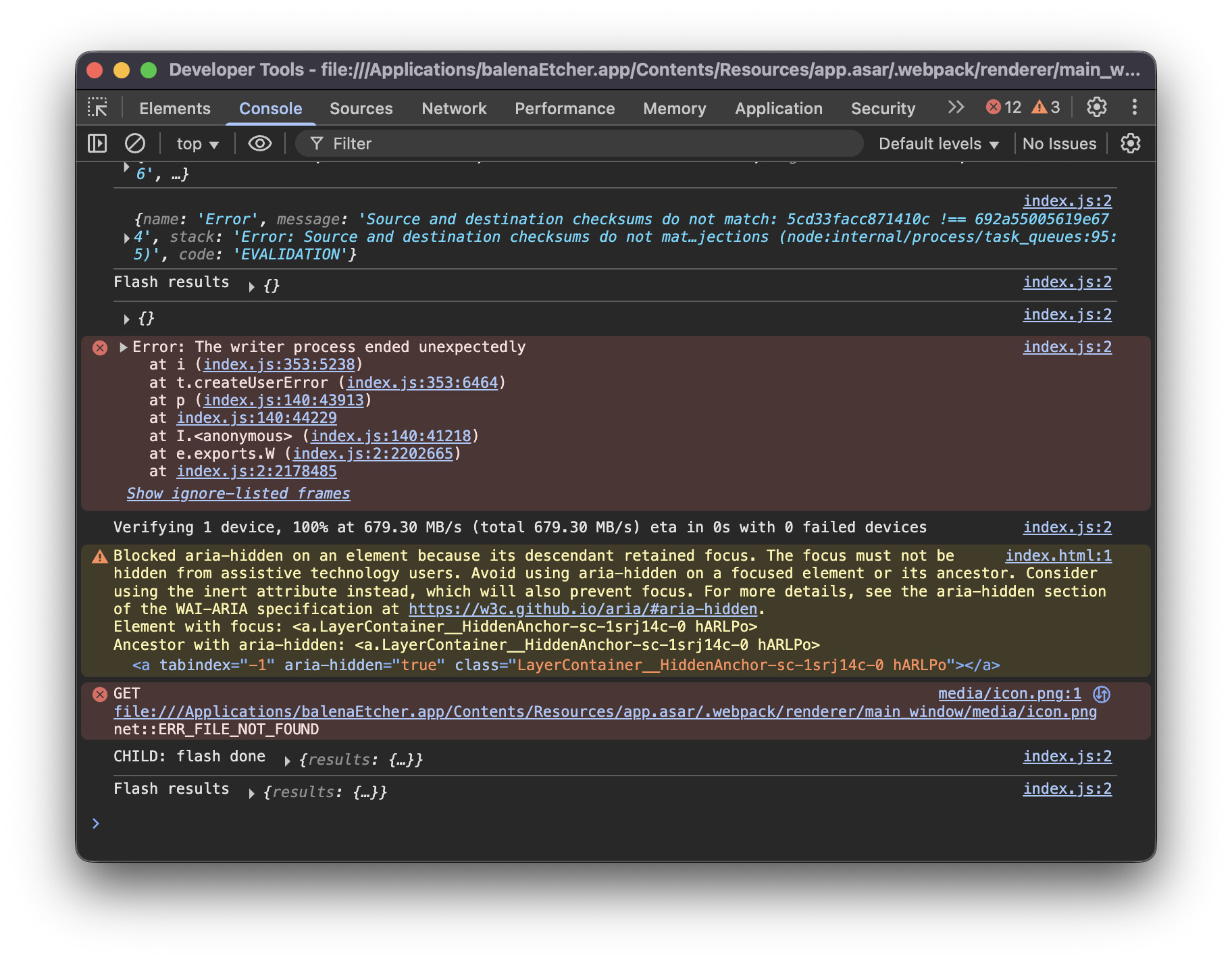

Below are screenshots of the error and the debug console messages:
As far as I understand, this is a failure of “Balena Etcher” not of Home Assistant, but the only imager tool listed in HAOS’s installation instructions doesn’t work. Any advice?
Oops. I wrote too soon. Found a fix and am posting it here in case anyone else finds this and is trying to do the same:
It turns out that the .xz image file is actually compressed. You can decompress it (double-click on it if you’re using a Mac), and then try the process again using the decompressed image file. This completed successfully.
