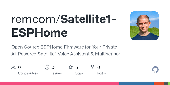

Look up remcom’s yaml for sat1. I guess it adds sendspin support
Got a link?
It still sounds. Like we still have a ways to go yet.
