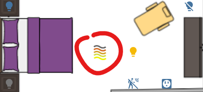

And it shows like this:

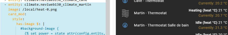

This is what it shows:

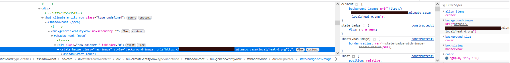

'Inspecting the code produced by the picture elements card, I see this for the image. It looks like it’s inserting the heat-5.png over the heat-0.png?
And this is for when I inspect the code produced in the Entities card. It’s showing this image in a completely different way. I
I played with has-image and background-image that I’m seeing on that line but that didn’t do anything. The image never changes.

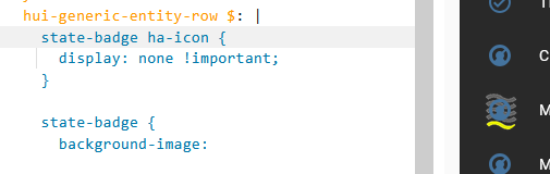

Try “display: none !important;”.
Note that any card-mod styling has a transition which is more or less visible. And in some cases the same can be achieved by using other methods like “external JS” or simply creating a template sensor with a dynamic entity_picture.
Thanks, still shines through :frowning:
Looking at the CSS code, I tried ha-icon, ha-state-icon and ha-svg-icon. I tried before and after the the state-badge block.

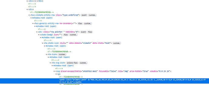

Check your screenshot , the inner ha-state-icon element is located under state-badge - but also inside a so called shadow root.
The shadow root in cardmod is presented as “$”.
To better understand how it works, go to the main cardmod thread - 1st post - fantastic link at the bottom, it will lead to lo a list of tutorials and examples.
Might be useful.
Of course in case if you are ready to learn ))).

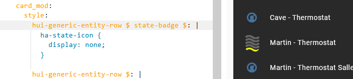

It… WORKED!
So, with the template, this is the whole thing, in case someone else stumbles upon this later :slight_smile:
