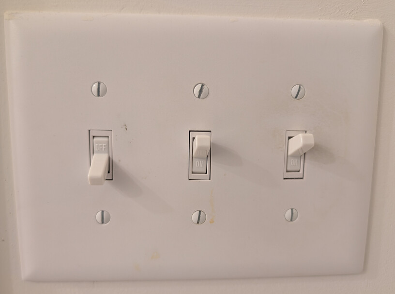

I’m planning on replacing my bathroom switches with smart switches. Except for the left most switch which is the ceiling fan. The furthest right switch are the main lights. The middle switch is the shower light. I’m thinking of replacing the two dumb light switches with the Zooz double switch below. Then get a different plate which omits the middle switch.
Does this sound like a reasonable plan? Maybe there are better options?

Why not replace all three? You will likely want to automate the fan at some point based on humidity.
I have same setup and used two dimmers for lights and a zen71 for the fan.

Zen72. I use those all over the house.
My fan has a humidity and motion sensor so I didn’t really need to add a smart switch. The problem was a night the fan might randomly decide to go on (we get fog and the humidity goes up) and/or someone would go into the bathroom in the middle of the night and then the fan makes noise. So, I wanted to have it on a schedule.
I have the fan now turn on based on a separate humidity measurement (actually I compare the bath humidity to the humidity in the next room where the replacement air comes from). I found it responded faster to a shower that way. Some day I’ll put a motion sensor in the shower.
