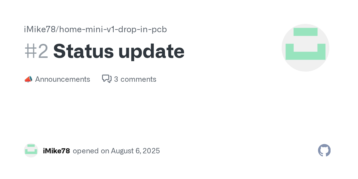

FYI, iMike78 posted an update saying that he recieved the first “Home Mini v1 test batch” (initial physical circuit board prototype test recieved from PCB manufacturer) and the hardware itself seems sound (pun intended) so ESPHome can be flashed to the ESP32 and working fine, but he is however having some problems with the XMOS firmware and is requesting help here → Status update · iMike78/home-mini-v1-drop-in-pcb · Discussion #2 · GitHub
Would be awesome if some embedded developer with experince of the XMOS firmware and XTAG4 (XMOS JTAG debugger) could reach out to him and offer advice or suggestions so do not need to work in the blind:
For reference also see previous related discussion here → 📢 Project Status Update – June 21, 2025 · iMike78/nest-mini-drop-in-pcb · Discussion #15 · GitHub

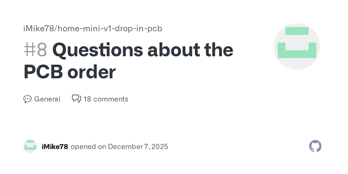

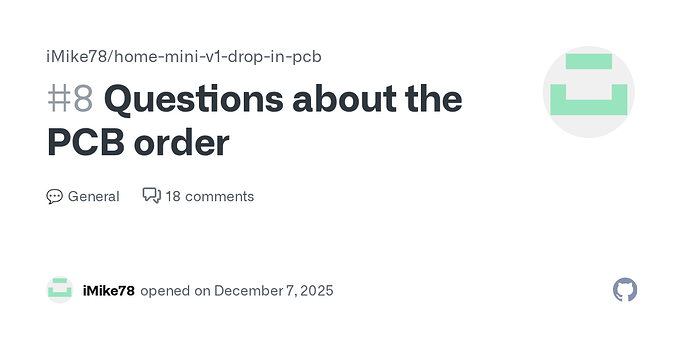

FYI, @iMike78 has posted here on GitHub that the first version of MiciMike Google Home Mini drop-in PCB (for the Google Home Mini Gen-1) by iMike78 can now be ordered via PCBWay Shared Projects → Questions about the PCB order · iMike78/home-mini-v1-drop-in-pcb · Discussion #8 · GitHub
He is collecting questions (and answers) about PCBWay orders for the here MiciMike Google Home mini drop-in PCB by iMike78:
Note! That is now the very first initial public release so at this time prices will be extremly high and would suggest that it is currently primarily targeting cutting-edge thinkers and developers.
