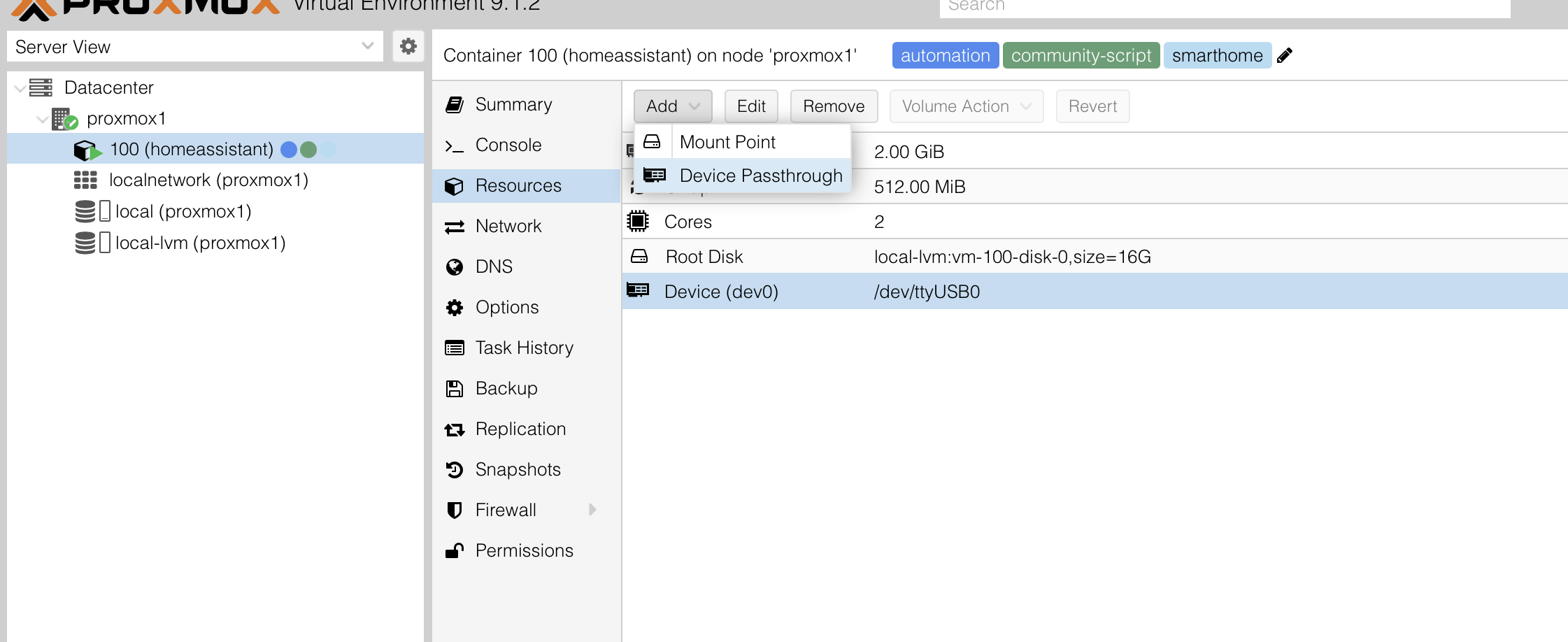

Hi All, I have searched online quite a bit but i am not able to get answers for the below.
A quick update and an issues I am facing. I have finally got the home assistant installed and running on a mini PC (Ryzen 5).

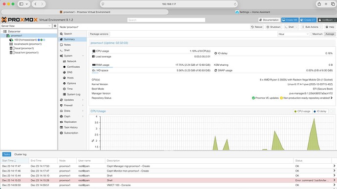

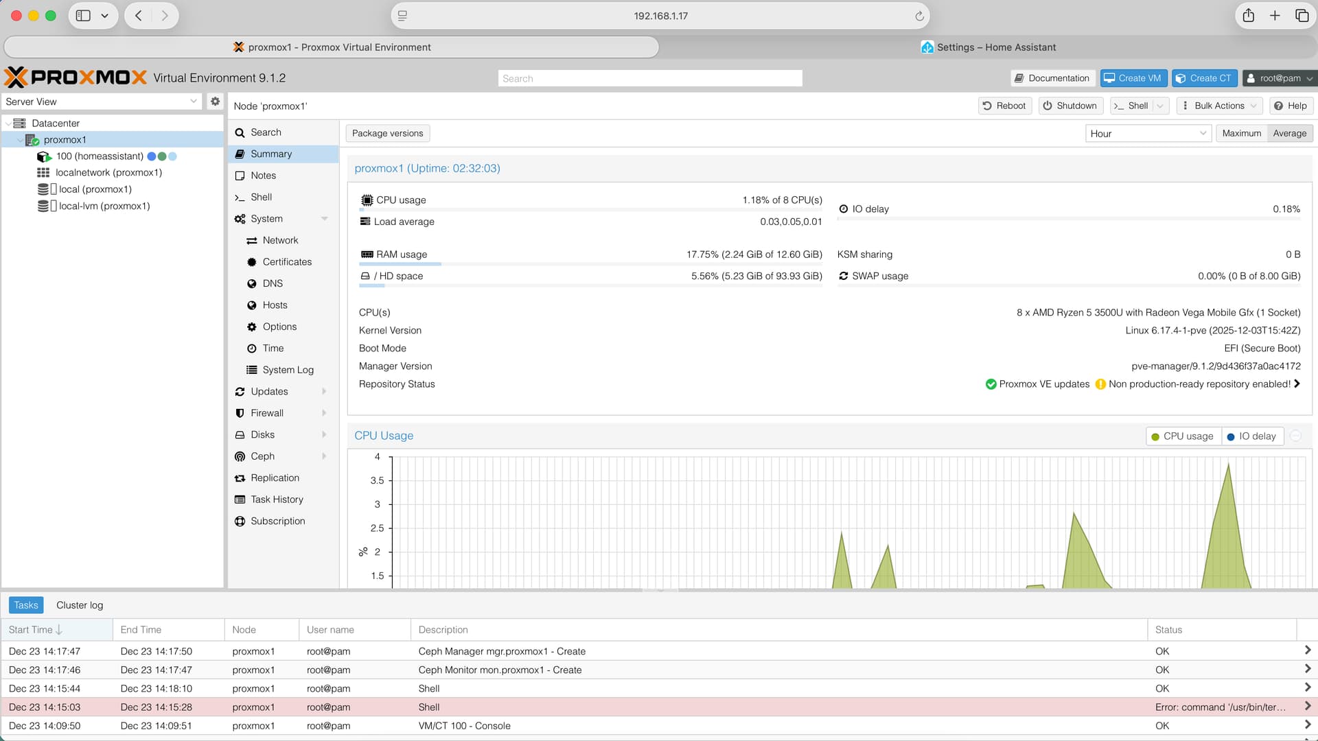

Q1. I have plugged in the Sonoff Zigbee 3.0 device in the USB port of the Mini PC, but I am not able to see it in the Home Assistant dashboards or in the notifications Tab. I am trying to find the Hardware option in Proxmox to add the USB passthrough as per the below picture but I am not able to see it.
My Home Assistant and Proxmo Screenshots for reference.

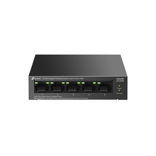

I bought POE Gigabit port to connect my Reolink cameras.
Really really silly questions, I have connected the Port 1 to the reolink camera and it received the power.
But when I tried to connect the Port 5 of the gigabit router to the Router (to get to online), it almost restarted or shut it self as I had to restart the whole router.
how do I connect the Gigabit Router to my Router to get it online to how I see the camera in HA?

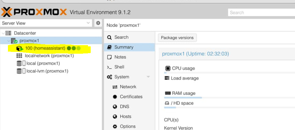

You’re in the wrong section. You need to click on the homeasistant VM in order to see the hardware option

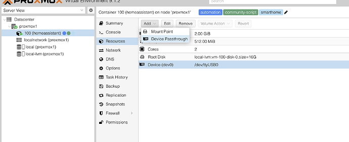

hi, below is the screen shot of the homeassistant VM and it still does not show the Hardware option.

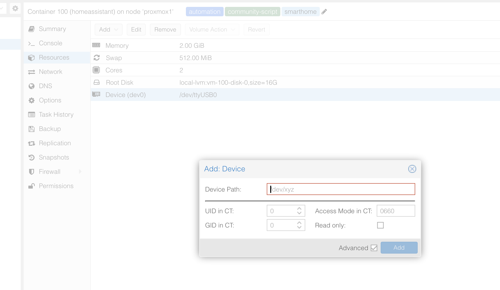

It looks like “Hardware” was renamed to “Resources” in ProxMox 9.
If you click on the “Add” button, can you add a USB Device? If so, that’s what you want.
I have tried that too but I don’t know the path for the USB port. How do I find that one?

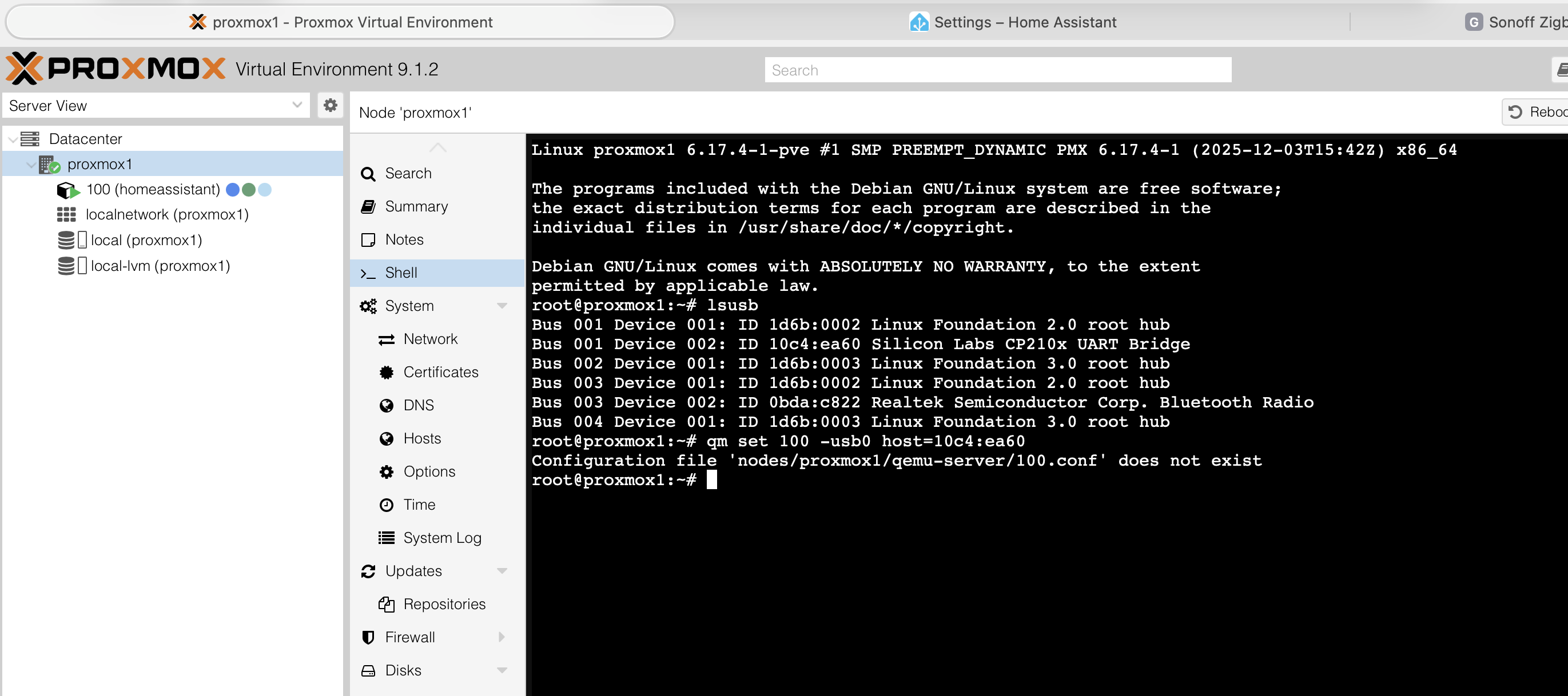

Are there any commands I could use to find the path in the console window?
I thought newer versions should be more easier, but seems little bit trickier.
Hi, Also I have been also trying add the USB from Proxmox as per the below guide.
https://pve.proxmox.com/wiki/USB_Devices_in_Virtual_Machines
On the left side my VM ID is 100, which is not working.
Am I missing the config file or I didnt install proxmox correctly :frowning:
Ahh! Found your issue (at least one of them :slight_smile: ).
You have HA running in a ProxMox Container, when what you want is a Virtual Machine (VM). Proxmox supports both, and they each have their advantages and drawbacks. But for a system like HA, running under a VM is much easier - including specifically for passing through USB devices.
Did the instructions/guide you followed want you to set up a Container? If not, go back and redo this section to create a VM instead. If the guide did lead you to create a Container, I’d recommend a different guide. This one is excellent: Installing Home Assistant OS using Proxmox 8
Note that if you’ve invested meaningful effort in your HA (Container version), you can make a backup and store it elsewhere (Google, Nabu Casa, etc.), then restore that once you’ve got HA successfully created within a VM. Or, if you’ve not done much with HA so far, you can just start again in the new environment once its created.
Hi @PecosKidd you are spot on mate. Thank you so much for the link and it everything is working perfectly.
