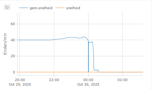

I do see my sensor go to 0 at midnight, see pict1
But shortly after it returns to the original value.

with the result as shown in pict1.
pict2 shows what I want. The orange line show the actul speed. the blue line shows the average speed. The blue line going to 0 at app 11:20u is when I iomplemented your code yesterday.
What I want is what you see in pict2, but with the blue line going to 0 at midnight and staying there. (unless we start the mill again during the rest of the day
Suggestions?
