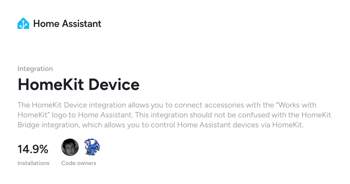

Unfortunately I do not have any Apple devices, so home kit isn't a good option for me, I have an old iPad from when my son was in high school and needed it. Maybe I'll see if I can get that thing to turn on and get the home kit bridge setup.
You don't need any Apple devices to use the HomeKit Device integration. That integration "tricks" the HomeKit device into thinking it's pairing with an Apple device so you can use it.
