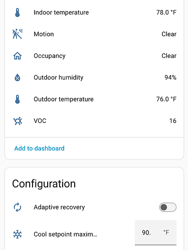

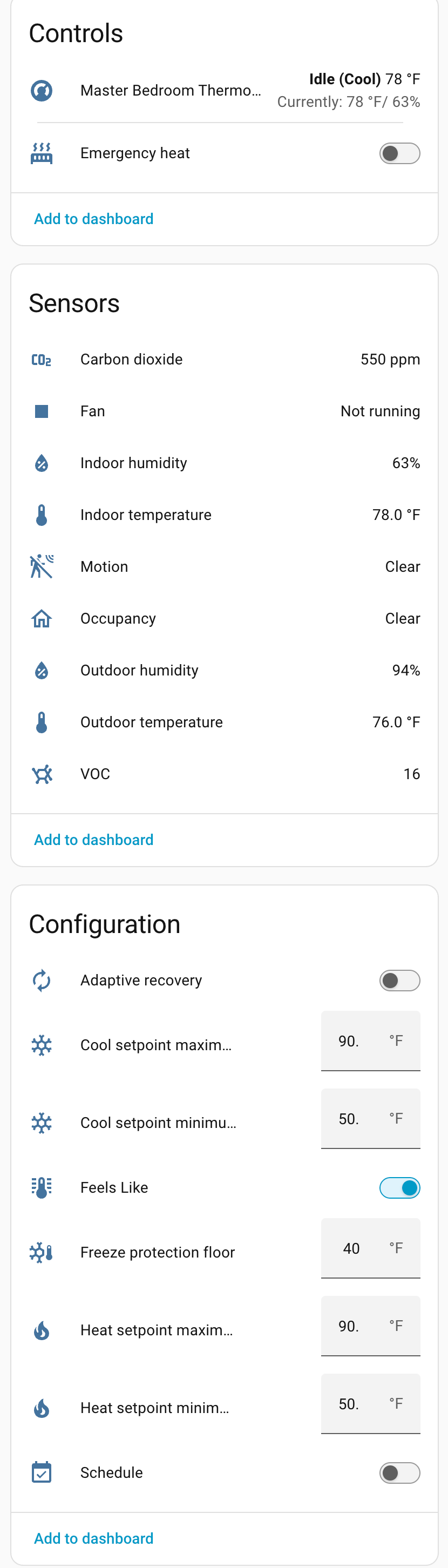

  • Room sensors are first-class devices — per-room temperature, humidity, motion, and occupancy, with switches to exclude a room from averaging.
  • A full climate entity — heat / cool / off (+ auto where supported), target range, fan Auto / Circulate / On, temporary & permanent holds.
  • Only what your hardware supports — entities appear per device capability (COâ‚‚/VOC on air-quality models, ~45 diagnostic entities for the nerds), no dead tiles.
