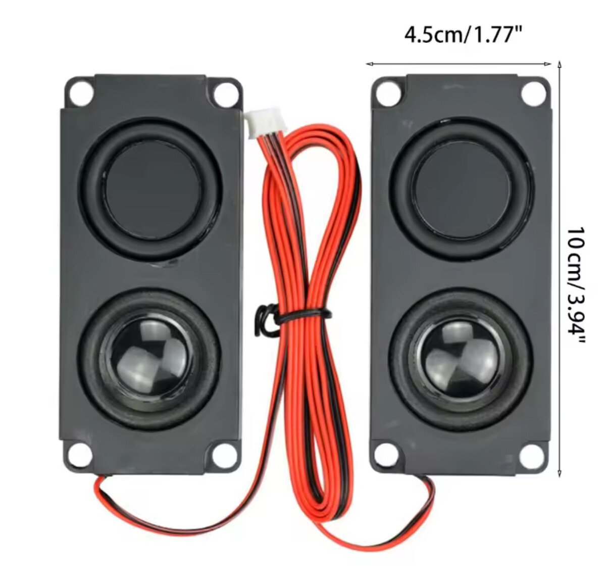

If you want some advice on a suitable speaker… I’ve tested a few and so far the best (passive) one is this one:
5W8Ohm bulky… but has a very good audio extension and high volume without distorting.
The other alternative is a 12V mono mini audio amplifier with a 10w audio jack input with a passive speaker (you would need to use a 12-5v transformer for a single power supply).
A single passive speaker connected to the respeaker works well, but in my opinion, it needs a suitable resonance box. Otherwise, the audio doesn’t have the right depth.
Hm, specs on Respeaker say 4Ohm impedance. But if 8 works okay - that’s great! I didn’t actually try it at all.
I actually bought two 8-ohm ones to put in series… but I realized they were a bit large and using them together or alone the difference is little or even none.
Using higher impedances doesn’t cause any problems except perhaps a reduction in power… but I can assure you that you can’t keep it at maximum (I keep it at 60%).
They sound very similar to today’s most popular assistant speakers.
the dimensions are also similar to the respeaker… perfect for creating a symmetrical box.

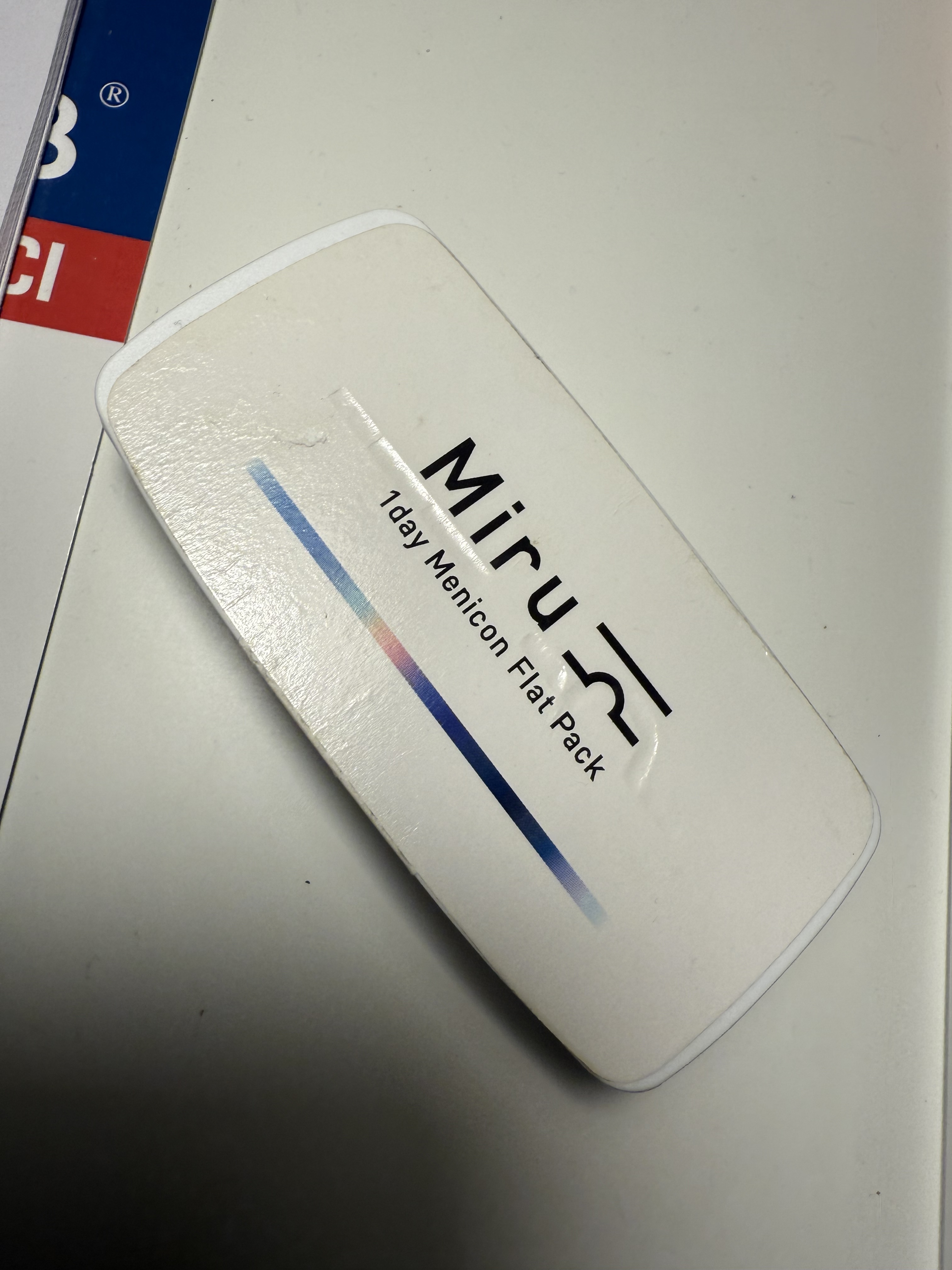

Since I don’t have a 3D printer, I’ll make do with what I have… this is a contact lens box:

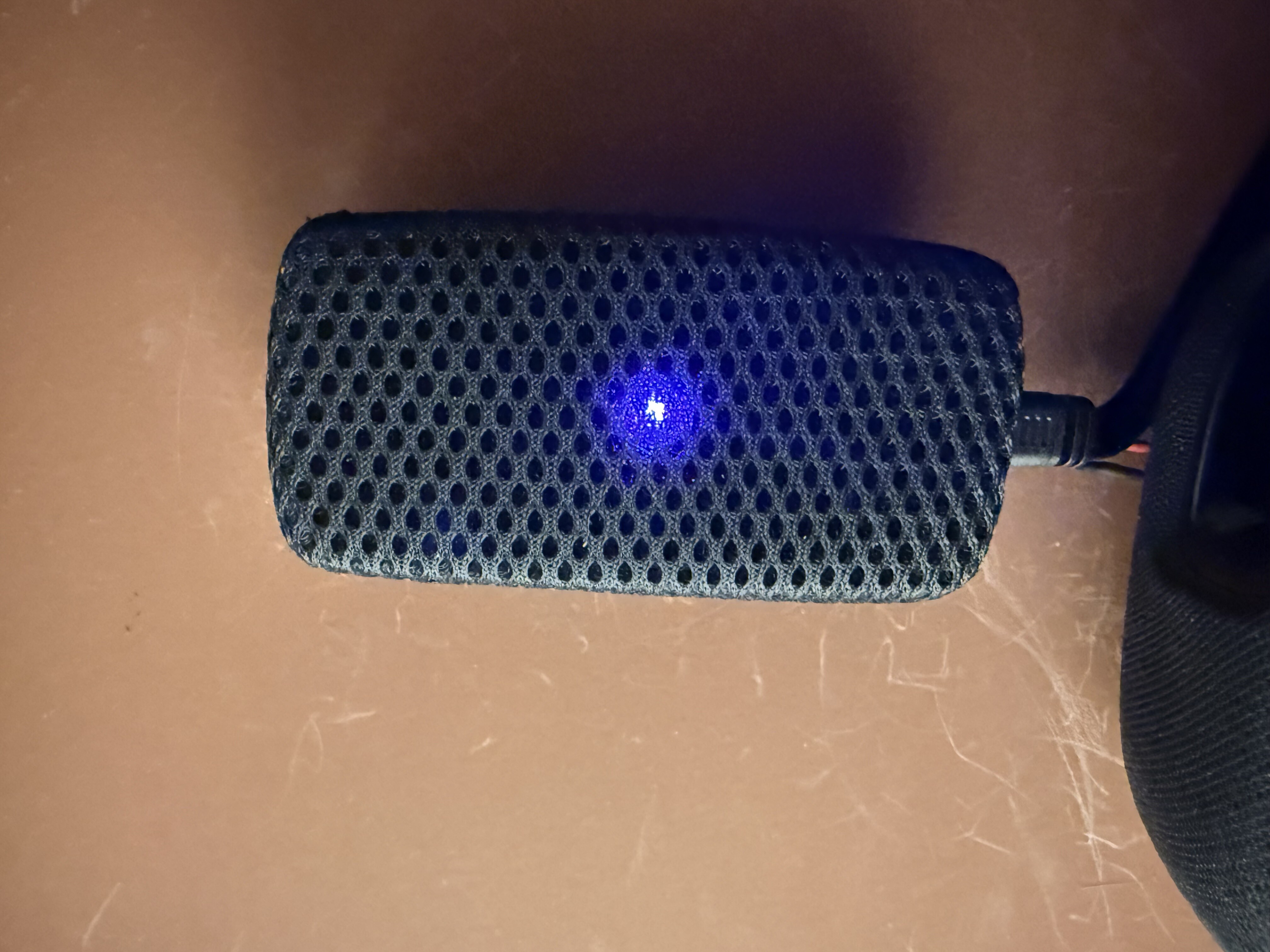

and this is the same box after the transformation:
