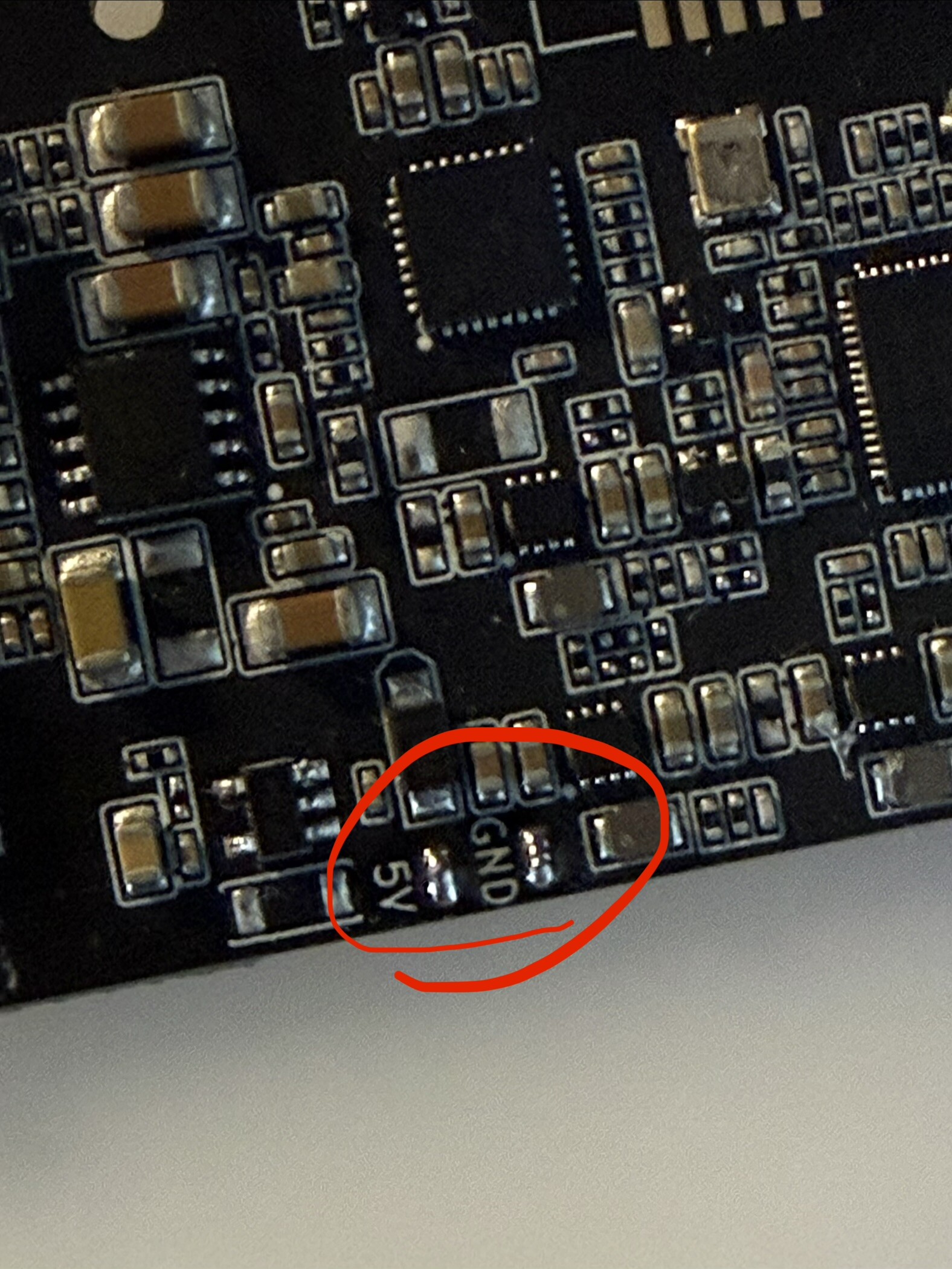

can I power the Respeaker Lite from these two pins only?
any contraindications?
I do it in my devices. Works good.
