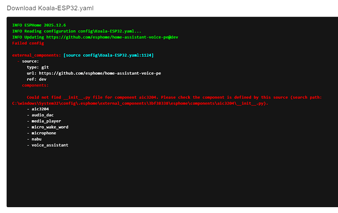

I built this satellite some time ago and it has been working perfectly so far.
When installing a new internet router, I need to update my Wi-Fi settings in the configuration. Unfortunately, I get this error message during the update process.
Can anyone help me fix this problem? Thank you very much!
It feels like cache problem. Try deleting hidden .esphome folder and rebuild.
Thanks!
Done…but one step later…

Error: Detected a whitespace character in project paths.
========================== [FAILED] Took 6.15 seconds ==========================
Sorry for this basic questions…its long time ago for me
I guess you changed something in config… This error means there’s whitespace somewhere it shouldn’t be.
Also your config is pretty old, I’d advise updating from repo - I see some old warning that was addressed.
Just checked if Koala is building - it does.
Resetting the device with new config got sendspin working, thanks.
It turned out it was using an outdated base.yaml, not the new one in the config folder.

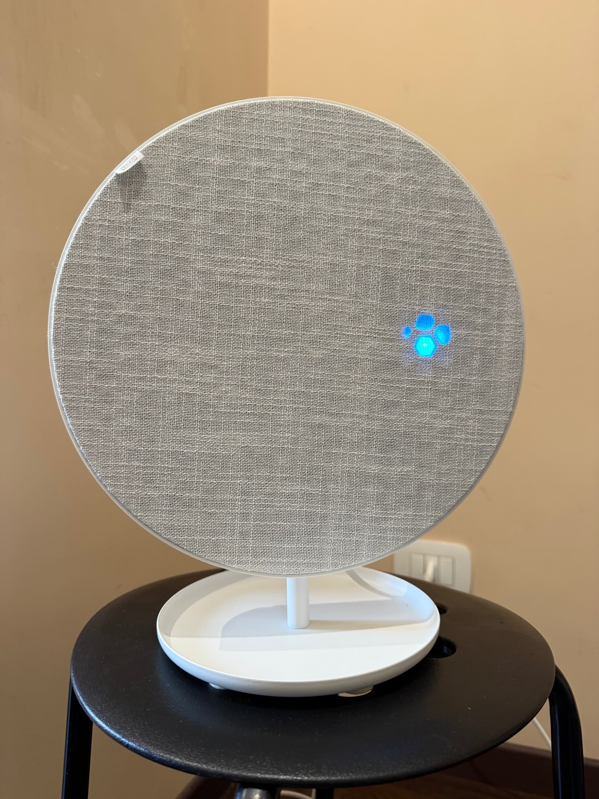

I just finished my project with Respeaker lite inside an IKEA SOLSKYDD…
I’ll post it as soon as possible. very beautiful and functional…
EDIT: posted the project: Voice Assistant with IKEA SOLSKYDD and Respeaker Lite
Nice one! I adore projects that add functionality to existing devices.
Would be great to have it with good sound - but I guess this can easily replace 3d-printing custom enclosure.

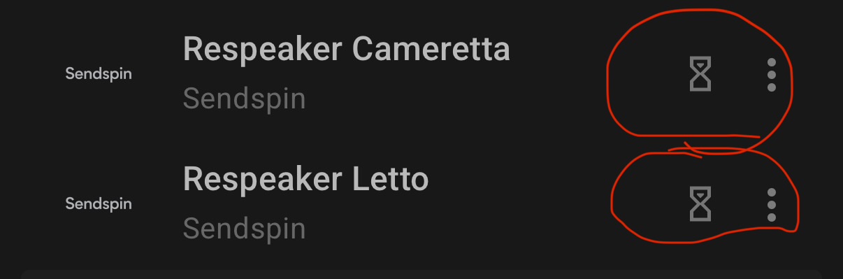

Does it also happen to you that sometimes Music Assistant doesn’t load the Respeaker as a Player?
Nope… If device is in network, it’s in MA…
To get it working again I have to remove the power from the Respeaker and reconnect it.
Hmm, some bug maybe in initialization…
This happens when HomeAssistant crashes…
Lately I’ve been having crashes with HA, especially when I make music requests to my assistants or overly complex requests and commands.
I manage everything with a Raspberry Pi 4 2GB, maybe it’s time to upgrade to a mini PC.
Oh damn, yeah I guess it’s time to add juice. :slight_smile:
Yeah you need to get yourself a more powerful computer for Home Assistant.
