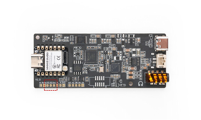

I am experiencing an issue with my ReSpeaker Lite device where it seems to continuously trigger listening even without saying any wake word.
I am using the “Okay Nabu” wake word.
From the logs, it looks like the wake word is being detected randomly, and the voice assistant pipeline starts (STT, microphone streaming, etc.), but no actual speech is provided. This results in repeated stt-no-text-recognized errors.
Additionally, it behaves as if the physical button is being pressed intermittently, even though no one is touching the device. This triggers actions and sounds unexpectedly.
There is also a constant “ping” sound (notification sound) happening repeatedly, which makes the device quite noisy and unusable.

Did you solder USR button as it’s said in instructions? Without that it sporadically calls clicks on it, because that pin is floating by default.
I didn’t see anything about that in the documentation.
However, based on this hint, I changed the button configuration to the following:
binary_sensor:
  - platform: gpio
    pin:
      number: GPIO3 # D2
      inverted: true
      mode:
        input: true
        pullup: true
It is now working properly.
Thank you very much for your help.
There’s section with literally this text in main README:
ATTENTION! This step is mandatory, as without it the buttons on satellite won’t work as intended.
Whatever works for you, but for working buttons they should be soldered to corresponding pads. Without that you can’t use them to pause music, stop ringing timer, or call the assistant without wake word. Same with programmatic mute control.
I just got one of these and I saw that in the documentation, but wasn’t sure exactly what it meant. Do you just solder a jumper wire between the two holes ie Mute and D3 and D2 and User?
Yes, for everything to work correctly. Jump-wire them by pairs.
