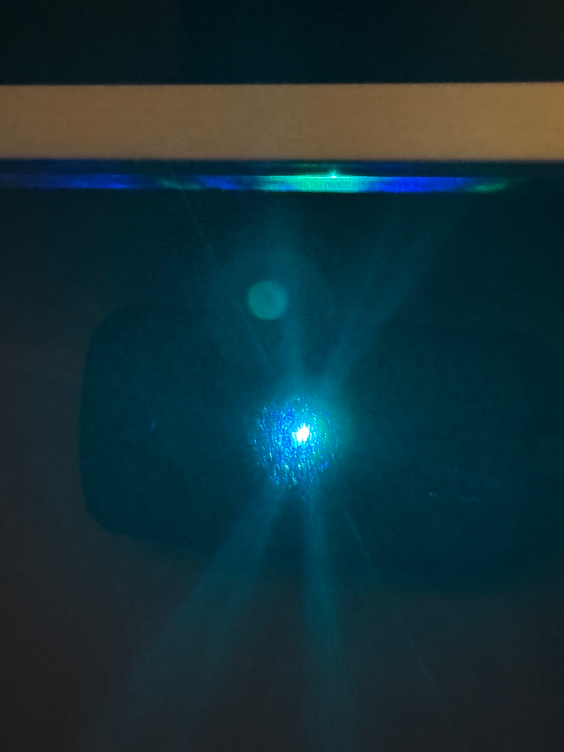

I updated to last release… but the led still there… sometimes remain stuck
Verify that your buttons are bridge-soldered to corresponding pads.
They’ve been welded together for almost a year now… until a few weeks ago everything worked fine.
it doesn’t always happen.
Now it seems like sometimes the blue light gets stuck right after the response. But that’s not always the case.
