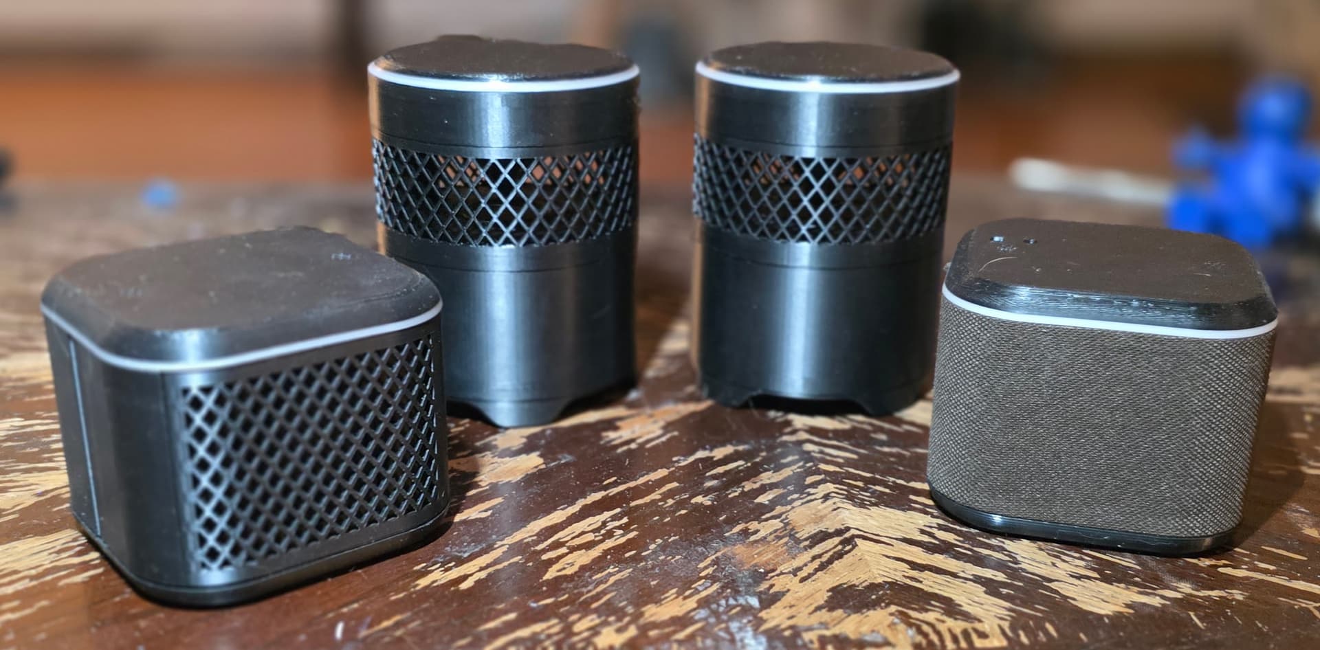

Here are my designs for the ReSpeaker Lite (short square) and ReSpeaker XVF3800 (tall round). Both have a 2" speaker and 2.5" passive radiator from parts-express.
I’ve noticed that the volume output of the XVF3800 is considerably lower than the Lite.
Both are also running your software (thanks!).
I love the design with the fabric! Been trying to design something simular myself but my one year old is apparantly more important :smiley: Would you mind sharing those lovely 3D files?
Here you go!
Uh, I see you use up-firing speaker (at least for XVF3800 that is). The main goal is to isolate board as much as we can from the influence of speaker. Don’t know if it won’t be prone to detection problems…
Yes, that’s a concern for sure. I was willing to experiment and see if the AEC can handle it. If not, I can always change the design!

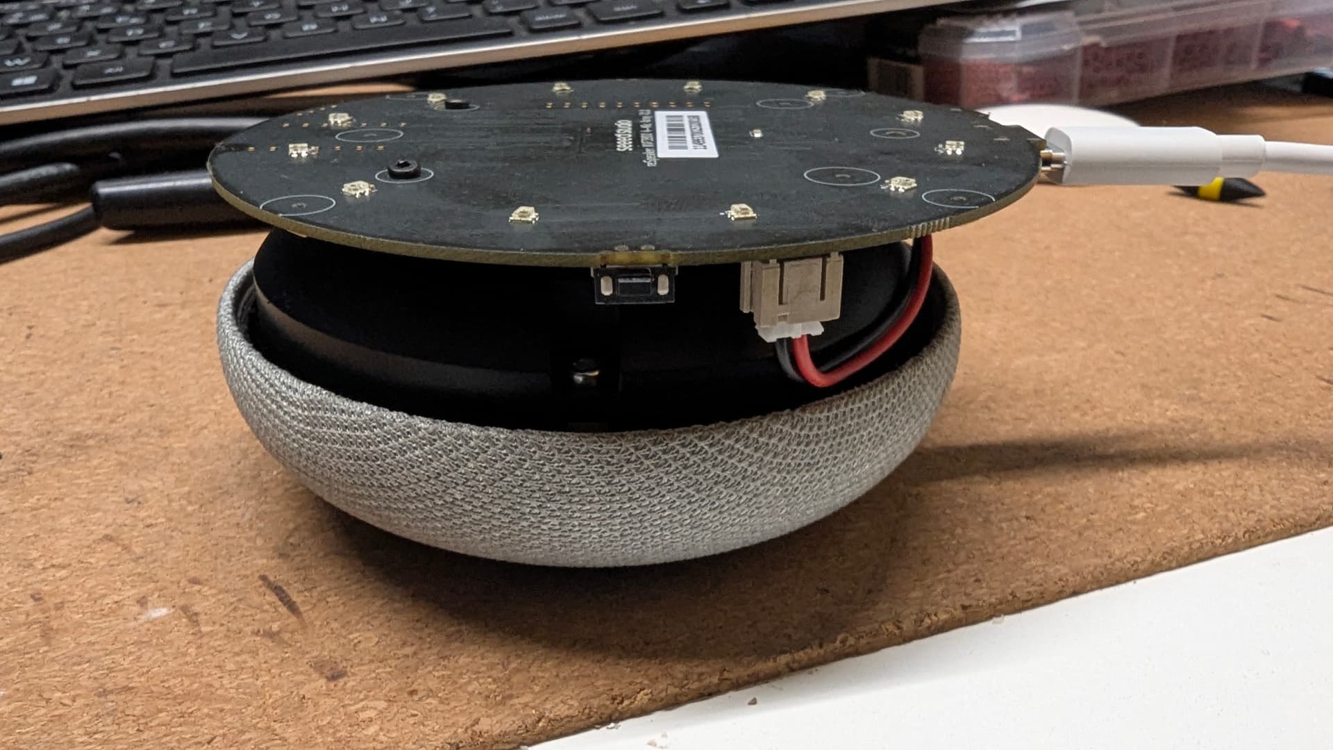

I had an old Google Home Mini laying around, stripped it for parts.
As I read the speaker is a 5W speaker it’d be perfect for the reSpeaker!
I stripped the connector and soldered a JST one on. Perfect fit!
Now I need to design a 3d printed case with clear PETG filament for the LEDs
