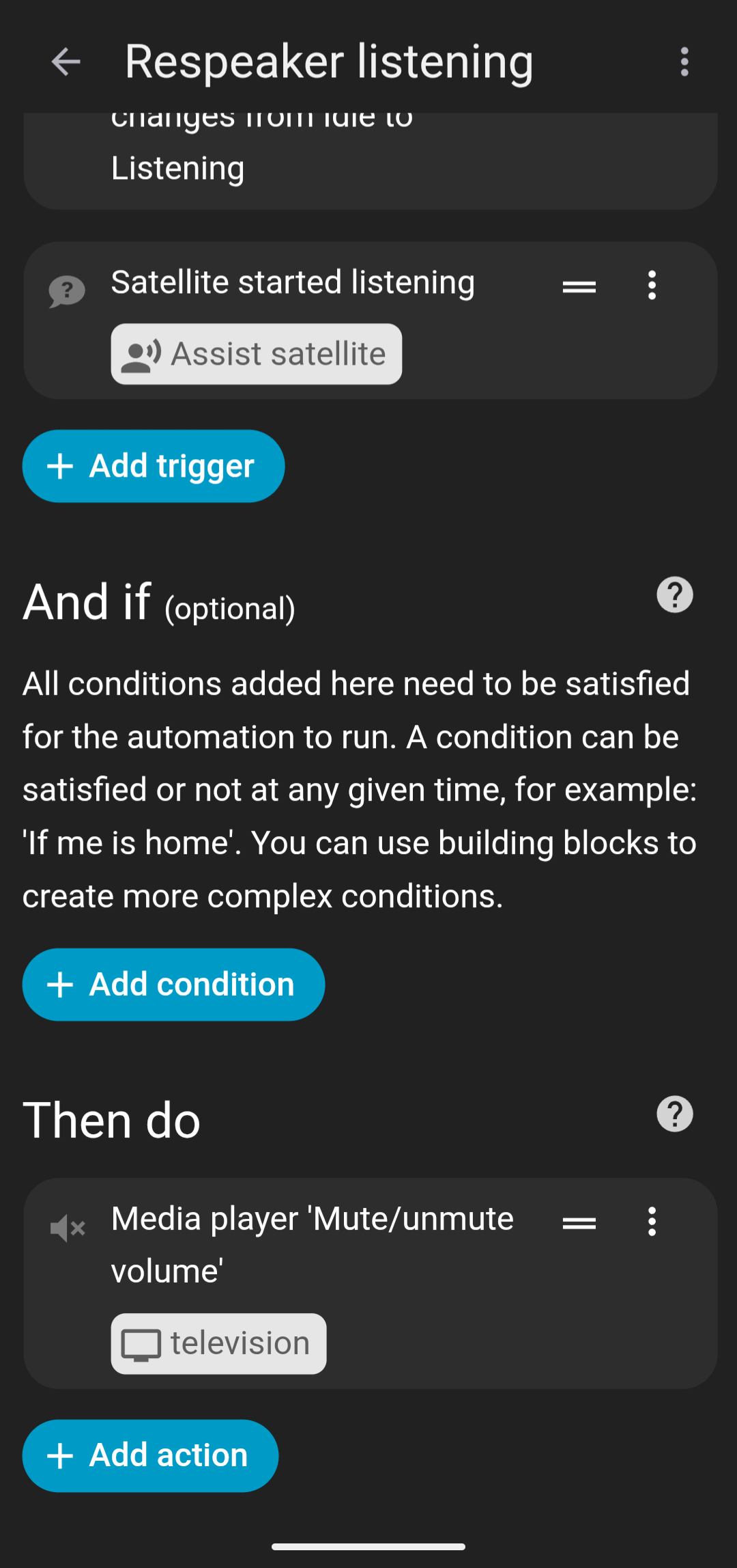

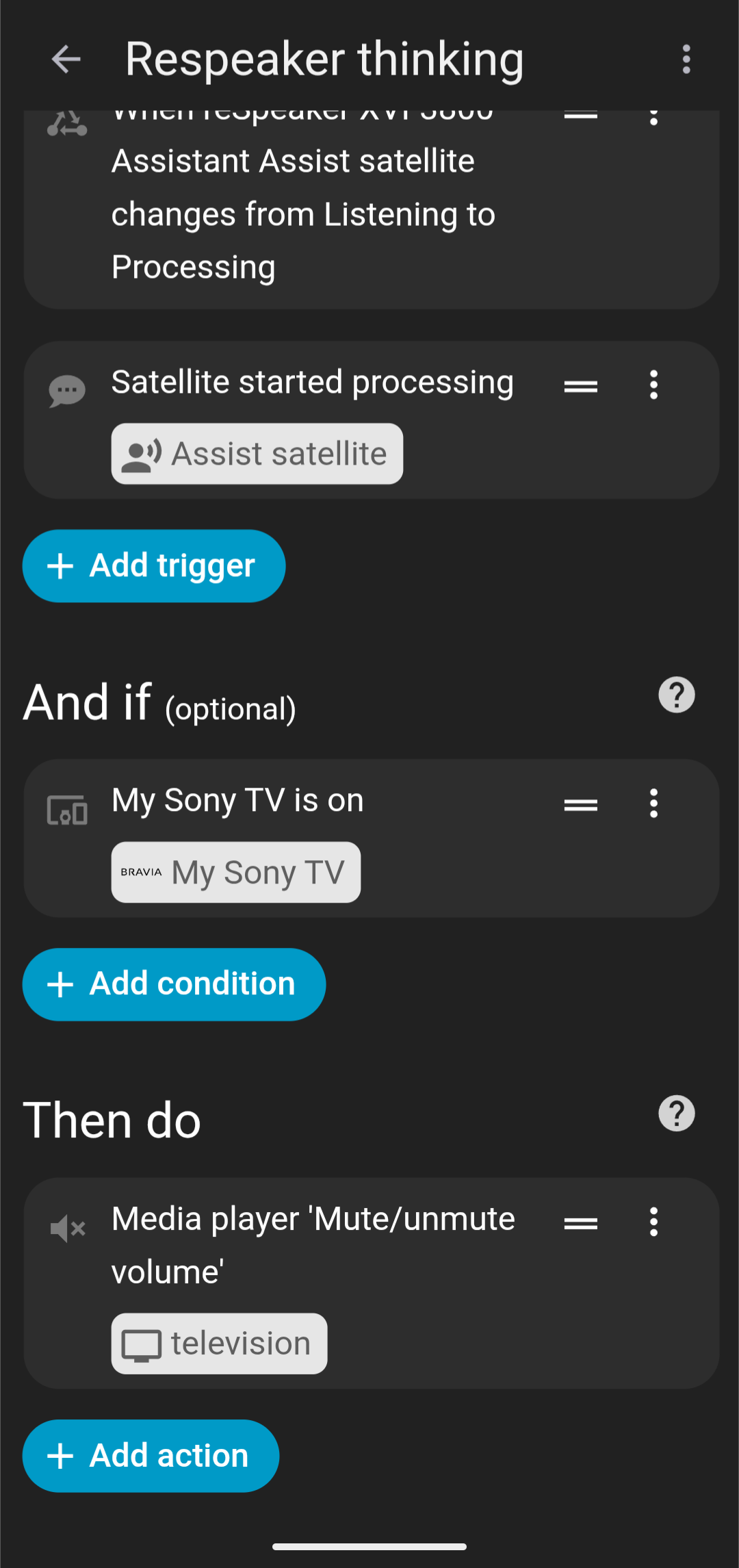

I still use automations to mute or take a snapshot of the TV volume , set the TV to a lower volume so it reliably understands me, then restores the snapshot using the same triggers as below. The trigger is “Satellite stared listening” and if you check mute check the checkbox after using the media player mute/unmute option. Then create another automation to unmute (unchecked) when the satellite starts thinking. The check mark is so it won’t mute your TV if it’s already muted and vice versa. That way it doesn’t hang on, if it has to go to my LLM for an answer it un-mutes while thinking so I don’t have to wait for it to start speaking before it un-mutes the TV
The top trigger is disabled as I created a template sensor before it was baked in as a trigger Honestly my [https://www.unfoldedcircle.com/](https://Unfolded circle) Remote 3has been super fast and accurate but it’s a remote control and you hold the button to talk then release and it’s not cheap but connects to the HA API to use almost all domains on the remote, along with other integrations but mostly setup via media players, scenes as activities and scripts to change any physical key functionality. Open API and all integrationsare open source. Hopefully the next model will be cheaper and more accessible.
8 have found overall the respeaker does the best at further distances but it’s also probably the same reason it holds onto the TV easier than the PE, not that the PE is great either. Honestly noise cancellation seems to be the last hurdle IMO. Wether it’s beam forming or some other method if you have 4 mics you should be able to isolate the person’s voice better. At the same time Amazon lost 25 billion on Alexa and Fire TV/tablets between 2018 and 2022 according to papers the New York Times got their hands on and most of it was from Alexa and keeping cloud servers up. Even with shifted hardware capabilities it’s still heavily cloud reliant. Running a GPU model of Whisper really helps for local only. PO iper can run on anything, it’s not resource intensive. Especially with streaming replies
I have blueprint for that.
