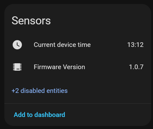

Just for my own sanity… You changed the way all this orchestrates, and it now updates the XMOS part automatically right?
I have the version with the case and ESP-S3 soldered, just received yesterday. It seems I only had to do the yaml/esphome part. Once I installed, I then realized I should maybe flash the newest XMOS first… But when I open it in HA it does say “1.0.7”

Yes, every ESPHome firmware version has corresponding compatible DFU firmware inside, and on first boot it installs that into XMOS. It might not work, if the version existing is too old and doesn’t support flashing. I’m glad it worked for you!
