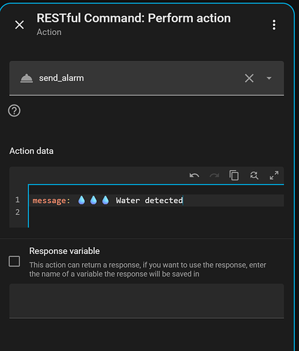

I’m setting up notifications (rest_command), but I need to create an Action field.
I added the following code in configuration.yaml
rest_command:
  send_alarm:
    url: "https://example.com/alarm/ha.php?msg={{ message | urlencode }}"
But unfortunately the Action field does not appear.
If I manually add it to the following:
  message: 💧💧💧 Water detected
action: rest_command.send_alarm
Is there a way to make it display Action data field without manually changing the YAML? What am I missing?
Thanks!
