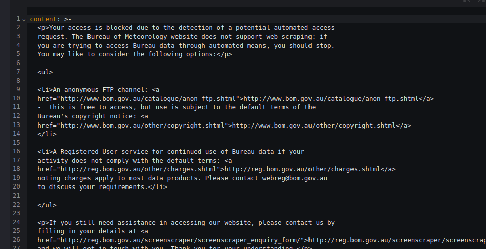

Thanks Petro. Tried this, and I get a status returned of 'unknown'.
Is there a way to check that HA is getting the same JSON from the web link as my browser?

Yes, turn on debugging for that integration and watch the logs
If you set it up as a Rest command the response variable shows:

Try adding a user agent so it looks like a web browser.
rest:
- resource: https://www.bom.gov.au/Etc...
headers:
User-Agent: Mozilla/5.0 (Windows NT 10.0; Win64; x64) AppleWebKit/537.36 (KHTML, like Gecko) Chrome/114.0.0.0 Safari/537.36
Content-Type: application/json

Thanks all, this was the problem.
