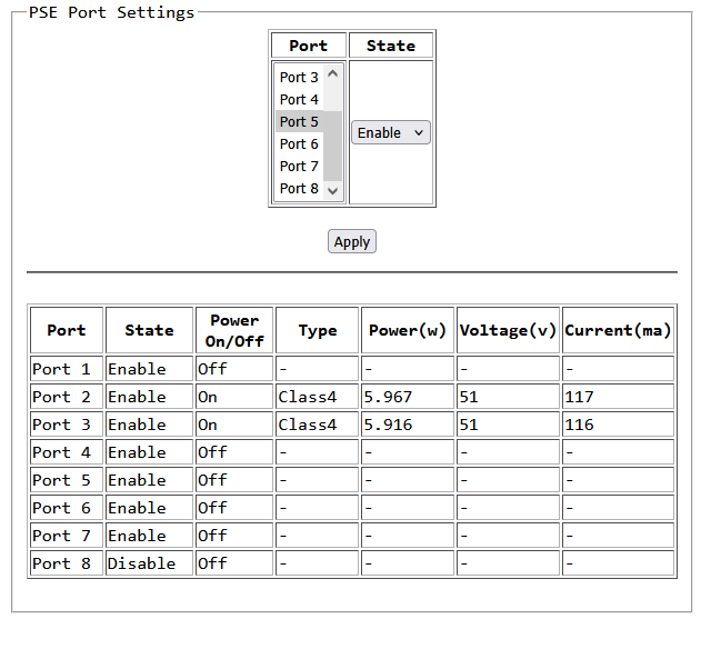

I have a cheap Chinese “managed” PoE switch and want to integrate some functionalities into HA.
I have figured out that I can authenticate by sending a password hash(?) as a Cookie header in my GET/PUT command, like so:
curl --header "Cookie: admin=xxxxxxxxxxxxxx" http://192.168.178.5/pse_port.cgi
In the above case, I get this page which is what I am most interested in:

Now I have two issues. First, the result has too many characters for a sensor. I understand that one way around this is to import it into an attribute, but I am unsure how. Currently, in my configuration.yaml I have:
sensor:
  - platform: rest
    resource: http://192.168.178.5/pse_port.cgi
#    scan_interval: 60
    headers:
Then, I would love to parse the text. I am interested in the tables:
<tr>
    <td>Port 2</td>
    <td>Enable</td>
    <td>On</td>
<td>Class4</td><td>5.967</td><td>51</td> <td>117</td>  </tr>
It is supposed to show:
Port #
State
Power On/Off
Type
Power(w)
Voltage(v)
Current(ma)
Is is possible to extract these into sensors of their own using, e.g. RegEx?
What you basically are doing , is accessing your device webinterface, which you could also do with a markdown/html card
Above is your html, and it’s underlying features, when calling the .CGI
Have you looked at the “scrape” integration ?
https://www.home-assistant.io/integrations/scrape/ .
Hi JC, and thanks for weighing in. The markdown/html card only loads the page like an iframe, right? That would not allow to e.g. add the power values to my energy tracking, I think.
