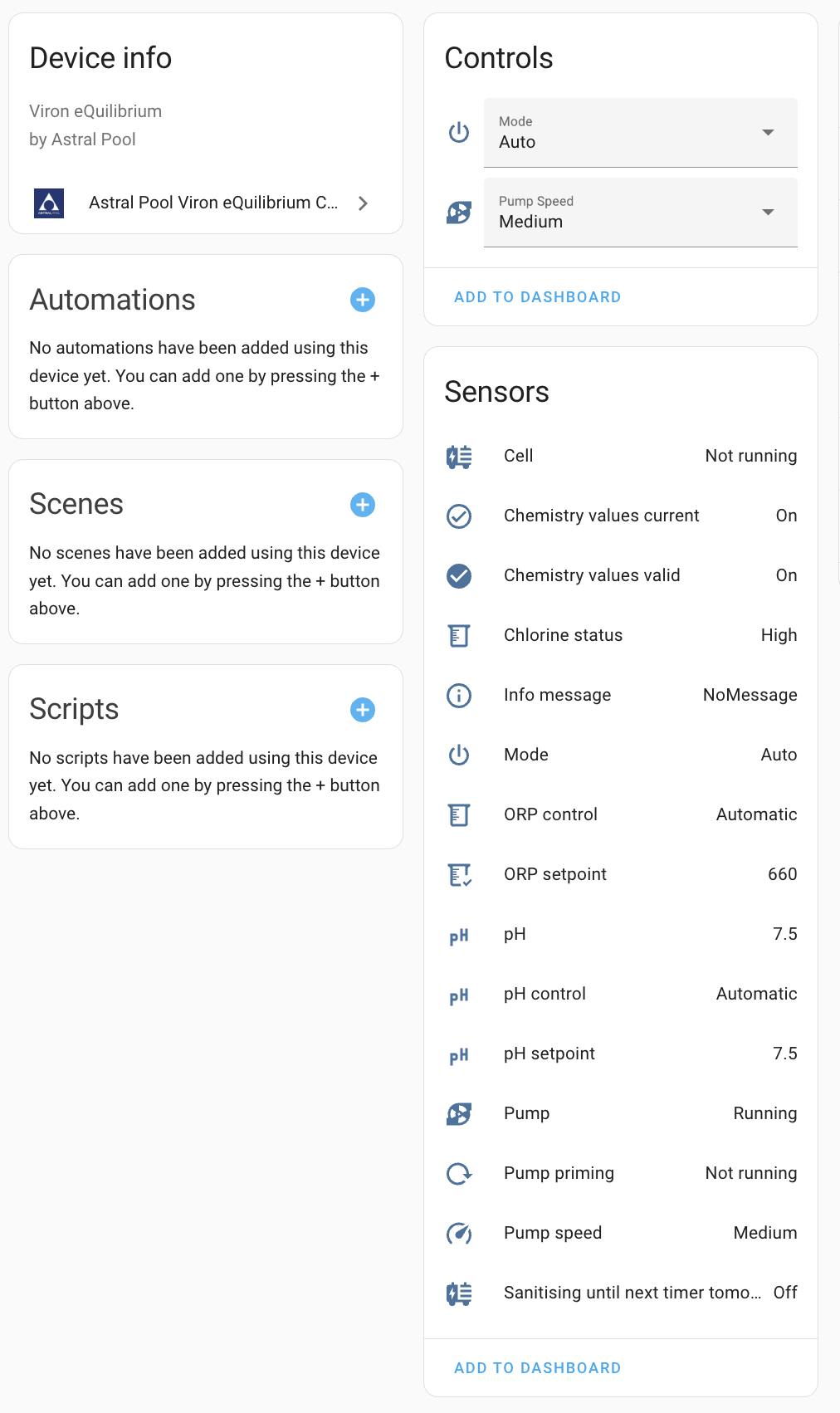

Yeah, found that it is Bluetooth. Just waiting for an ESP device to arrive. My HA is too far away for Bluetooth direct
Got it working finally! Seems much more reliable than the scrape. Would be nice if you could see the actual ORP reading though. Don’t know if it is possible through either the bluetooth or scraping the ConnectMyPool site but it would be also good to see things like timers or if the acid pump is running (dosing)

I can 100% confirm that the EQ does not spit out ORP over bluetooth.
It does send:
self.highest_orp_measured
self.lowest_orp_measured
And there is a flag to ResetStatistics
So I tried to get HA to routinely reset statistics, and read those measurements, but all I ever got was useless info.

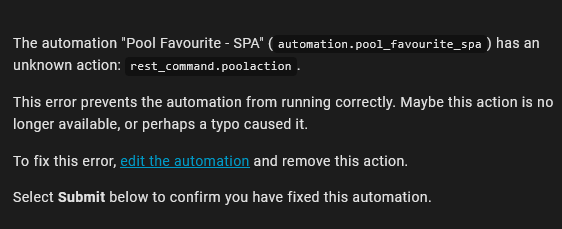

Curious, I thought I would take the plunge and update my templates as pointed out by @zagnuts double checked them all they seem correct but now everything is broken lol looks like its the rest_command thats the issue
I didn’t touch this at all… i even tried reverting back to the backup i took just incase and getting the same issue… anyone else having this issue?
Sorry for double post… looks like I was just being stupid and didnt do the templates correct…

Actually speaking of this, can you show me one of your automations? mine are still broken when trying to use ‘rest_command.poolaction’
Heh. Fair enough. FWIW I found using the ‘unique ID’ helps eg here is the horror (I do need to tidy it up a bit) that is extracted from my template.yaml file:
