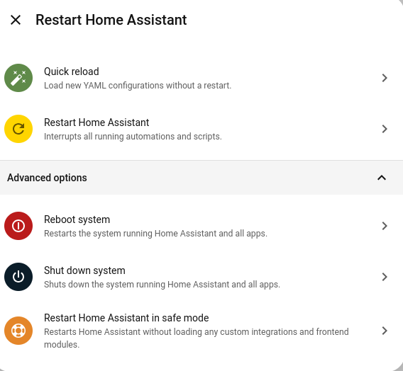

starting from a dashboard, it will take 5 button clicks to get HA to restart.
Consider the screenshot here. Why is there an expandable menu? Why does “restart home assistant” generate another promt asking if HA should be restarted? Why does “Quick reload” indicate that there will be another promt “>”, when there is none? Should not be needed to go to settings, developer tools, restart, then restart home assistant and then restart. Can we see a better workflow for this please?

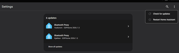

Try settings → the three dot menu

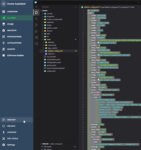

Download “Custom Sidebar” integration from HACS and try this settings. You can restart and reload with one click or one confirmation. Also you can modify according to your needs whole sidebar. And finally you can also restart without any confirmation with one click (not recommended due to mistaken actions)
Cheers,
order:
  - item: overview
    order: 1
  - item: studio code
    order: 2
  - item: store
    order: 3
  - new_item: true
    item: BACKUPS
    href: "/cebe7a76_hassio_google_drive_backup/ingress"
    icon: mdi:google-drive
    order: 4
  - new_item: true
    item: INTEGRATIONS
    href: "/config/integrations"
    icon: mdi:transit-connection-variant
    order: 5
  - new_item: true
    item: AUTOMATIONS
    href: "/config/automation"
    icon: mdi:arrow-decision
    order: 6
  - new_item: true
    item: SCRIPTS
    href: "/config/script"
    icon: mdi:script-text-play
    order: 7
  - new_item: true
    item: 'RESTART'
    icon: 'mdi:restart-alert'
    on_click:
      action: 'javascript'
      code: |
        openConfirmDialog({
            title: 'Restart Home Assistant?',
            text: 'This will interrupt all running automations and scripts!',
            confirmText: 'Restart',
            dismissText: 'Cancel',
            destructive: true,
            confirm: () => {
              callService('homeassistant', 'restart');
    bottom: true
    order: 8
  - new_item: true
    item: 'RELOAD'
    icon: 'mdi:reload'
    on_click:
      code: |
        callService('homeassistant', 'reload_all');
    bottom: true
    order: 9
  - new_item: true
    item: UPDATES
    notification: >
      {% set totalUpdates = states.update | selectattr('state', 'eq', 'on') | list | length %}
      {{ totalUpdates if totalUpdates > 0 else '' }}
    href: "/config/updates"
    icon: mdi:download
    item_background: >
      {% if totalUpdates > 0 %} green {% endif %}
    bottom: true
    order: 10
  - new_item: true
    item: DEV TOOLS
    href: "/developer-tools/yaml"
    icon: mdi:hammer-screwdriver
    order: 11
    bottom: true
  - item: settings
    bottom: true
  - item: history
    hide: true
  - item: snapshots
    hide: true
  - item: map
    hide: true
  - item: energy
    hide: true
  - item: media
    hide: true
exceptions:
  - device:
    - android
    - ios
    extend_from: base
    order:
      - item: overview
        hide: true
      - item: phone
        hide: false
        order: 1
        icon: 'mdi:cellphone'
      - new_item: true
        item: 'RELOAD'
        icon: 'mdi:reload'
        on_click:
          code: |
        bottom: true
        hide: true
  - device:
    - windows
    extend_from: base
    order:
      - item: phone
        hide: true
        order: 1
