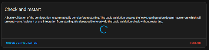

Hi all,

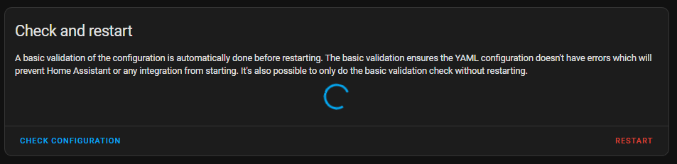

When I try to restart home assistant, it always stop at checking configuration stage.
If power off & on from wall plug, it open without any problem.
How to correct this?
