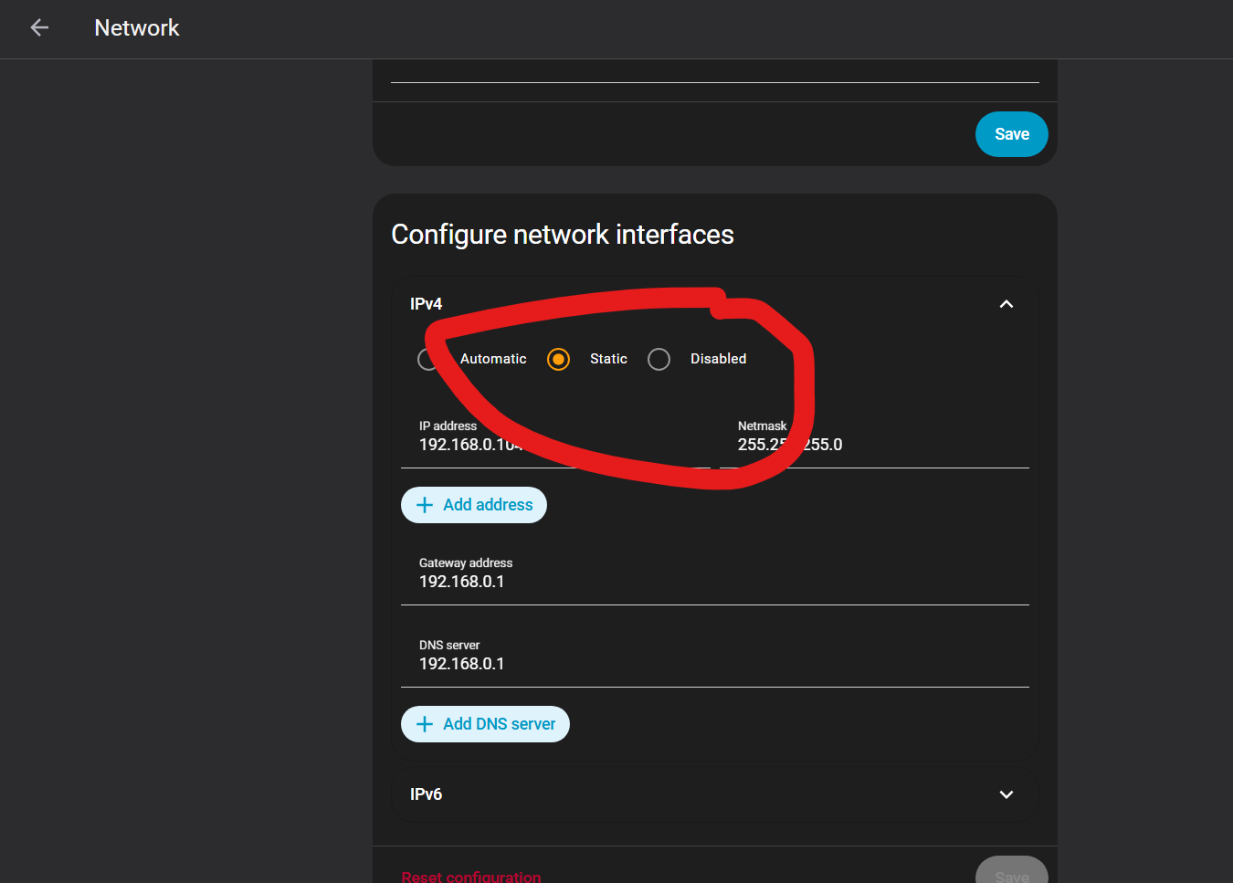

You need to set the IP address as static.
This is a different process for everyone, but is usually done in the router
One method is to set up a reservation in your DHCP server, usually part of your router.
For an Asus router, open the router page. On the left column click on LAN. Click the DHCP Server tab. In the Client Name (MAC Address) enter the MAC address of your HA instance. In the IP Address box, enter your desired IP address. Click on the (+) at the end of the row. Click on Apply at the bottom of the page.
If that’s not your router, google your router name + DHCP
Make sure it’s outside the dhcp range and you can set it in the GUI.
