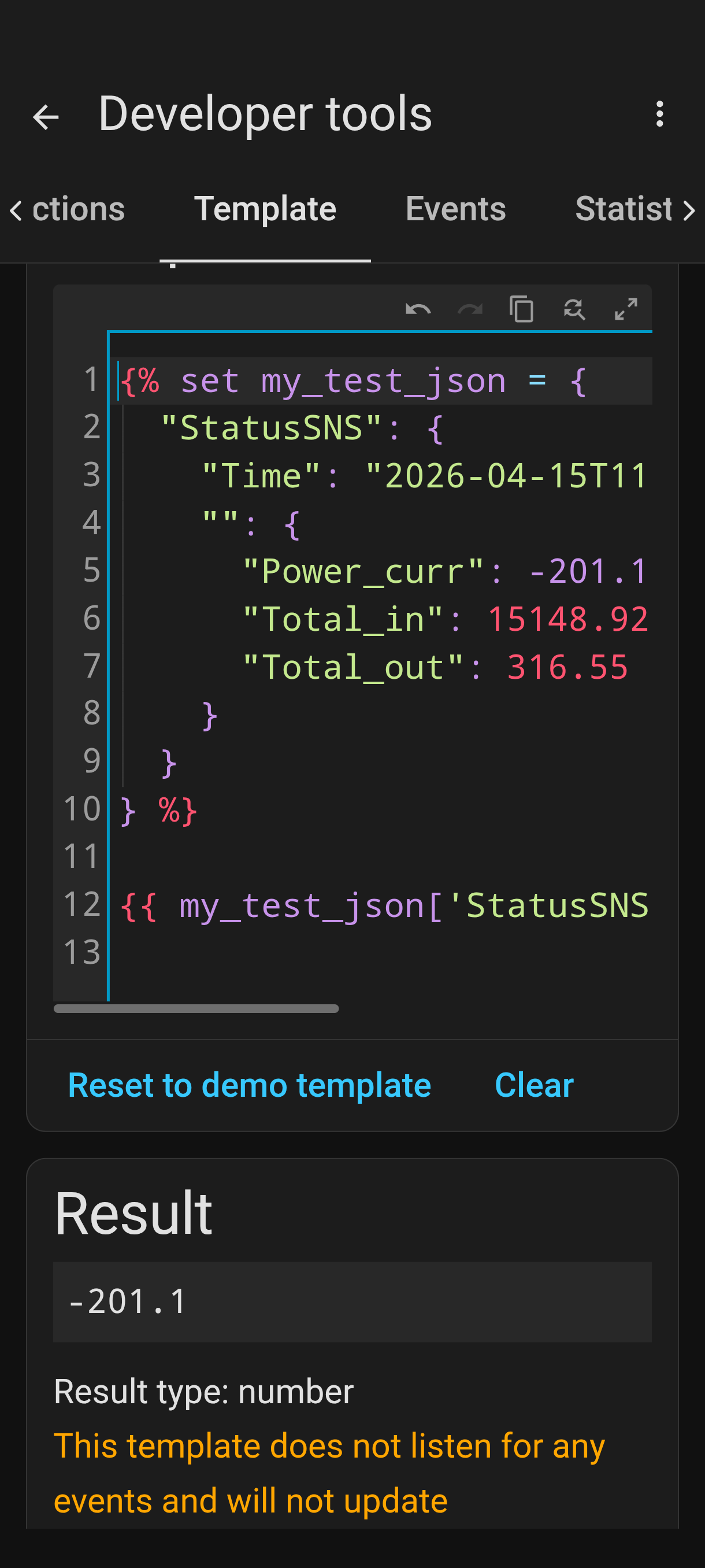

Maybe this works?
value_template: "{{ value_json['StatusSNS']['']['Power_curr'] | float}}"
Seems to work in template tools
This, works, nice :+1:
