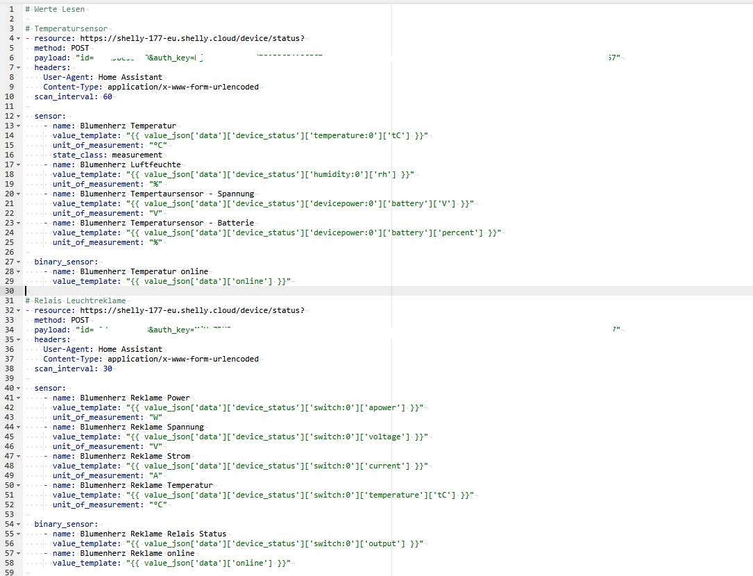

I’ve been having problems with my Restful API since yesterday.
I’m using it to read Shelly devices that are located on a foreign network. I use the Shelly Cloud and read the data there via the Shelly Server. Until now, it’s always worked without problems. Since yesterday, I’ve been receiving data sporadically.
If I go directly to the Shelly Cloud, I can see all the values ​​and status of the devices. If I go directly to the Shelly server (Postman) I can also read all the data.
I haven’t updated either.
Can someone help me?

Sounds more like a problem with the resource than your config.
