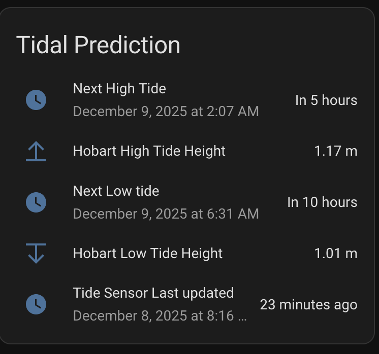

Anyone having issues accessing this now?
I’ve been accessing this data using command_line: with success until recently. Before I move over to rest, I just want to check that it’s still working for others.
update - got it working with rest:
Adding my thanks to those who’ve alredy worked this through in the thread. My minor variation on a theme is to switch to timestamps as device class to get the automatic rendering as follows:
rest:
  # BOM Tides
  - resource: "https://www.bom.gov.au/australia/tides/scripts/getNextTides.php?aac=TAS_TP003&offset=false&tz=Australia%2FHobart"
    scan_interval: 21600  # 6 hours
    method: GET
    headers:
      User-Agent: Mozilla/5.0
      Accept: application/json
    sensor:
      - name: Tide Sensor Last updated
        value_template: "{{ value_json.results.current_time | timestamp_local }}"
        device_class: timestamp
      - name: Hobart High Tide Time
        value_template: "{{ value_json.results.next_high.time | timestamp_local }}"
      - name: Hobart High Tide Height
        value_template: "{{ value_json.results.next_high.height }}"
        device_class: distance
        unit_of_measurement: m
      - name: Hobart Low Tide Time
        value_template: "{{ value_json.results.next_low.time | timestamp_local }}"
      - name: Hobart Low Tide Height
        value_template: "{{ value_json.results.next_low.height }}"
which I then threw into an entity card and added the ‘state’ as secondary objects to the times so I have both the actual time of the next low/high/last updated as well as the relative time to now
This working post BOM-Website refresh with a minimal user-agent
(What is it that most of the people working in this thread seem to be in Tassie :slight_smile: )
I just tried playing with your code - by adding it into configuration.yaml & changing the BOM code for my location. Unfortunately, I get “Unknown” as the rest.
Got it to work with further examples above, after spending an hour or so going down a vibe coding cesspit.

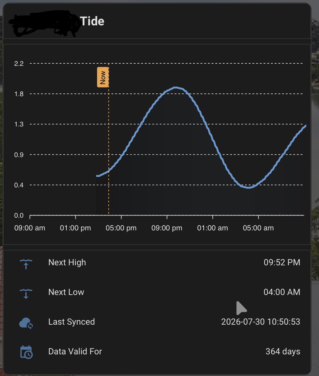

I’ve come back to this to redo it. I decided to try WillyWeather as it has more locational data and the 5000 free pulls will probably last me a lifetime with him I implemented it.
Through a pyscript, I did a 365 day API pull, located it in a JSON file, then a second function to work out next high and low tide every 15 mins. It’s not super accurate (due to not wanting to pay for API pulls), you could be more accurate but for my purposes this was good enough.
On the dashboard front:
• apexcharts-card — draws the actual curve. Fed from a short list of upcoming (and one past, so the line connects smoothly through “now”) tide events, interpolated with a cosine smoothing function rather than straight lines between points, so it actually looks like a tide instead of a zigzag.
• stack-in-card — merges the chart and a details panel (next high/low, last synced, days of data remaining) into one visual block instead of two separate boxes.
• card-mod — for shrinking/dimming the details panel so it reads as secondary info under the main chart.
Tide Dashboard — Full Code (WillyWeather only)

4. Dashboard card — merged chart + details
Requires three HACS frontend cards: apexcharts-card, stack-in-card, card-mod.
type: custom:stack-in-card
cards:
  - type: markdown
    content: "## Tide"
  - type: custom:apexcharts-card
    header:
      show: false
    graph_span: 24h
    span:
      start: hour
      offset: "-6h"
    now:
      show: true
      label: Now
      color: "#f2a541"
    yaxis:
      - min: 0
        max: 2.2
        decimals: 1
    apex_config:
      chart:
        toolbar:
          show: false
      stroke:
        curve: smooth
        width: 3
      fill:
        type: gradient
        gradient:
          shadeIntensity: 1
          opacityFrom: 0.35
          opacityTo: 0.02
    series:
      - entity: pyscript.tide_upcoming
        color: "#5b9bd5"
        unit: m
        type: area
        data_generator: |
          const events = entity.attributes.events;
          const points = [];
          const stepMinutes = 15;
          for (let i = 0; i < events.length - 1; i++) {
            const t0 = new Date(events[i].dateTime.replace(' ', 'T')).getTime();
            const t1 = new Date(events[i + 1].dateTime.replace(' ', 'T')).getTime();
            const h0 = events[i].height;
            const h1 = events[i + 1].height;
            const steps = Math.round((t1 - t0) / (stepMinutes * 60000));
            for (let s = 0; s <= steps; s++) {
              const frac = s / steps;
              const smoothFrac = (1 - Math.cos(frac * Math.PI)) / 2;
              const height = h0 + (h1 - h0) * smoothFrac;
              const t = t0 + (t1 - t0) * frac;
              points.push([t, Math.round(height * 100) / 100]);
          return points;
  - type: entities
    show_header_toggle: false
    entities:
      - entity: pyscript.tide_next_high
        icon: mdi:wave-arrow-up
      - entity: pyscript.tide_next_low
        icon: mdi:wave-arrow-down
      - entity: pyscript.tide_sync_status
        icon: mdi:cloud-sync
      - entity: pyscript.tide_days_remaining
        name: Data Valid For
        icon: mdi:calendar-clock
    card_mod:
      style: |
        ha-card {
          box-shadow: none;
          background: transparent;
        .card-content {
          padding-top: 0px;
        hui-generic-entity-row $: |
          state-badge {
            --mdc-icon-size: 16px;
            width: 24px;
            height: 24px;
          .info {
            font-size: 0.78em;
            opacity: 0.75;
          .info .secondary {
            font-size: 0.7em;
          .state {
            font-size: 0.78em;
            opacity: 0.75;
